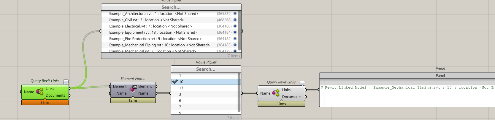

Could you please also show us an example of how to use the Name input to pull out one specific linked model among many? I’ve tried with model name (with or without .rvt), and full text (as “Revit Link Model : …. id …”) but it didn’t work.
Thanks
Hi hldk, Here i used the Element Name component to get the proper name (or you can use the value picker to select)
