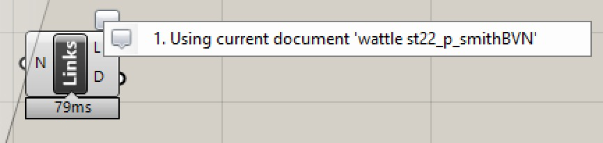

Hi all,
I had a question which relates to the document element links component in RIR.
I have been trying to implement that component usings Node in code. See the screenshot below.
But where previously there is a remark to tell me I am using the current document, it is throwing this message as an error. Returning no output.
The below RIR component used outside of code works fine, providing it as a remark
Is there a particular way I need to provide the node in code component the document? I have tried both the RhinoInside.Revit.ActiveDBDocumentand passing in the document from the RIR Active document component.
Or is that even the parameter it is looking for? I have had a peek at the source code here but I can’t find any obvious indication that it’s anything other than document.
Apologies in advance if I have missed something blatant
Cheers, Pete
Hi @p_smithuk,
I have to look more in detail to know what happens here, but I guess is because the component by default has just one input and is not the document but the Link Name.
Here an alternative.
RiR-QueryDocumentLinks.gh (10.8 KB)
