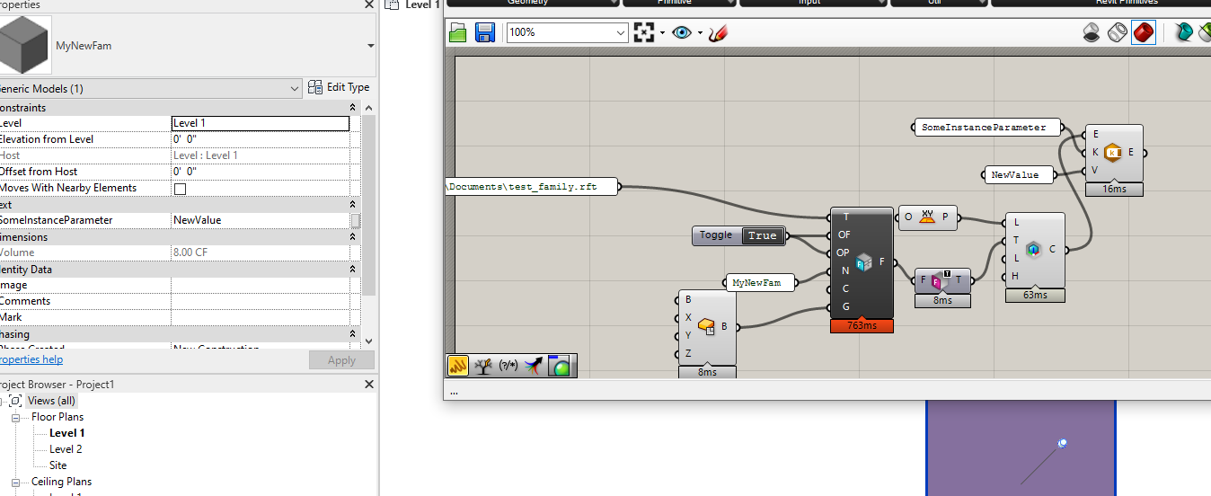

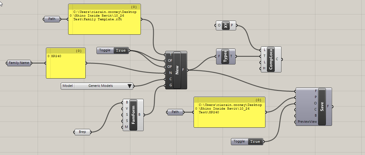

I’m new to using grasshopper & RhinoInside Revit, I’ve created a family in Grasshopper using a Revit family template with custom instance parameters for metadata input. The family works within Revit and I can see and edit my parameters in properties, the issue I’m having is that when using the same grasshopper routine & same Revit family template to bring in a second element into the project as a family, the parameters are no where to be found in the second family.
I’m assuming the issue is with Revit but I have attached my grasshopper for reference.

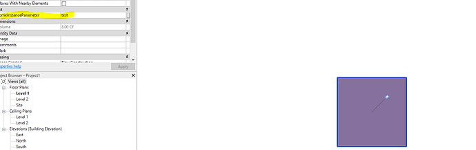

If you add a parameter to the template it will come in with the new family. You can then overwrite using Set Parameter component.

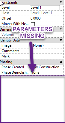

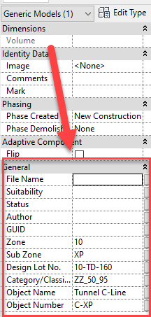

I don’t need to overwrite any parameters with grasshopper. My issue is that the first family works perfectly with the parameters in Revit (image 1). When creating a second family for a different 3d element with the exact same script the parameters are missing (image 2).
Note: both families are in the same project and I’ve just noticed that the properties are different
Image 1
Image 2

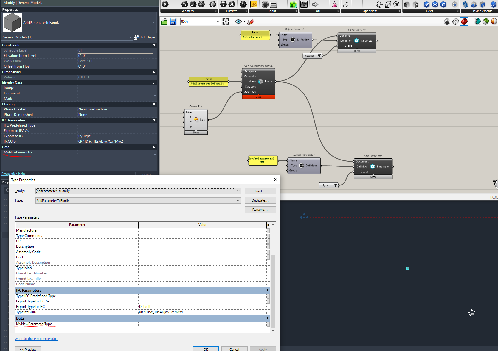

I’ve been looking for a way to add parameters to a newly created family. I assume that this is not possible and the best way to do this is through a custom template? I was trying to define add and assign a parameter to a family similar to what one would do to an element but that did not work.

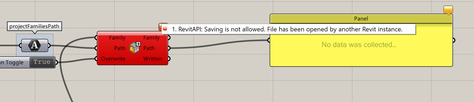

Anouther thought I had was to save the file open it add parameters and then reload it in the current document but I was getting an error message that the file was in use by Revit
The template file is a good enough work around for now, but if there is a way to add parameters to a newly created family please do share. Thanks.

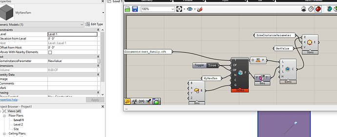

Hi Benjamin,
You can add either Type or Instance parameters to the Family Document like so…
Got it. That makes sense. Thanks!

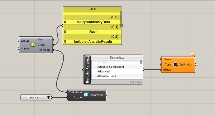

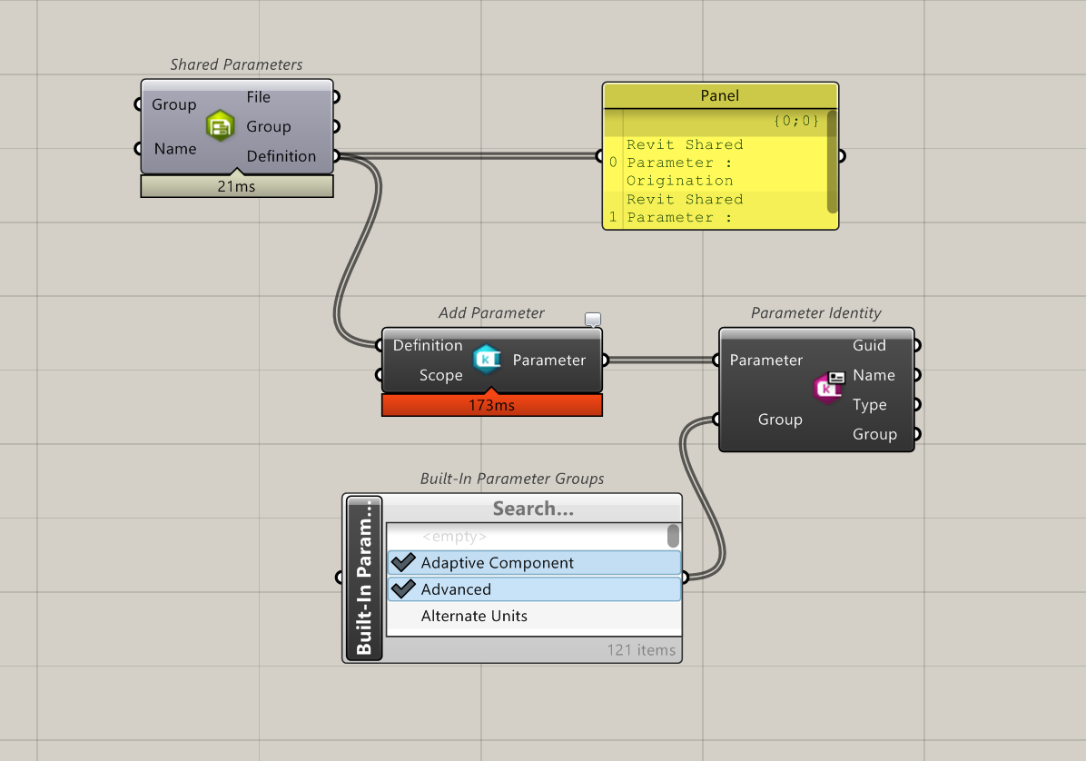

Is there a way to group shared parameters? There are shared parameter groups but these are custom groups that you can use to organize your parameter and have no relationship to the grouping of parameters in the Revit property panel.
You would somehow need to feed the shared parameter into a define parameter component and then assign it a group, this is what you do when you assign a shared parameter to file.
No idea why they built shared parameters that way, with their own unrelated groups or don’t give them the ability to assign them to the parameter group you see in the property window.
Once you’ve created a project parameter from your Shared Parameter use the Parameter Identity to assign/modify groups.
