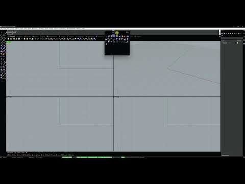

I have installed Rhino WIP today and saw some strange behavior on the toolbars.
  1. The toolbars are changing names to …(01) when pulled of the tab to be shown permanently in another edge on screen. Is that normal? How to show toolbars correctly?
  2. Toolbars dragged cannot be reduced to single line of icons. Why?
  3. Toolbars dragged below a certain border on screen will show strange graphical behavior as below:

Hi André -
That is normal, yes. In Rhino 8, all panels and toolbars live in a “container”. It’s the name of the container that you are seeing.
I don’t know about the “why?” part of this, but the request to make that possible is on the list → RH-71817 Floating toolbar groups cannot be sized to be a single row high
I’m not seeing that here. Can you post your screen’s DPI and scaling info?
Hi Wim,
My screen resolution is 5120x1440, the scaling from the windows settings is 125%. I have posted a high res screenshot below.
I wanted to be them single line as I have the analysis bars always on the lower right edge.
Just now I thought if its possible to go a step further and integrate several toolbars on the lower edge of the screen. Up to now I have the Osnap placed there and more is only possible if they are free floating. Which causes me sometimes to accidently move them.
I noticed in the new arrangement the Osnap contains the filter bar as well. I’m working with filters a lot and like them to be on screen at the same time in order not to switch back and force.
Is it possible to create a new toolbar which shows both?

Hi André -
That image is only 1920x540 and I can’t really see what’s going on.
Isn’t that the Osnap panel floating over a viewport in the lower left?

Hi @BauerNaval I suspect Discourse is scaling these images down. pls send them here with a link back to this thread
Hi Wim,
to answer your question:
The OSnap Bar is placed below the Layout buttons and not floating.
Putting several one a container together is not my point.
I’m using filters and Osnaps often at the same time, disabling some of their options on both and I don’t like to switch back and force between the toolbars and a container.
For example when I’m drawing or editing curves and there are already many different other objects in the file, I’m choosing curves only and when switched on the edit points only these can be selected.
This allows in large models not switch off dozens of layers or the hide lots of objects.
My models usually have 100 or more layers, sorted deck by deck. Hiding and getting objects back can be time intensive just not to catch the wrong item.
So having both Osnap and Filters available at the same time has worked well for me.
The Filter Bar is floating indeed as its not poosible differently. The only other chance is to waste another line of space on screen.
And that’s exactly the point, I want them not to waste another line, I want them to be side by side in fixed positions. And if possible other toolbars as those floating in the lower right edge as well.

Hi André -
Since you posted this in Serengeti and we are discussing Rhino 8, no, in your Rhino 8 picture that one is floating:
It doesn’t sound like you understood what I was trying to say about the new Rhino 8 system. Also, it doesn’t sound like you tried using the *.rhw file that I posted. Why not?
Hi Wim,
true, in the WIP Screenshot the Toolbar is floating as I didn’t manage to place it as in R7 on the lower edge. That’s the reason I posted the screenshot from R7 as well. One of my questions was if it’s possible to have it the same way in WIP8.
Thanks to the User Inju I managed to place several parallel there.
I’ve been using Rhino for almost 20 years now, but never came across an rhw file. And I haven’t found any note in the help or on the Internet. As Inju came with the links at the same time I stopped searching for how to convince Rhino to read it.
I believe I have understood the container concept quite well, there’s nothing complicated about that.
But I’m working on my own, no people around to share experiences with.
It’s looking like this now and that’s even better than before.
Still it would be convenient to have sidebar changing according to the connected tab above.
Hi André -
That’s because that is new in Rhino 8. As is the container system.
Run the Rhino WindowLayout command. From the gear drop-down pick “Import window layout”. Then select the *.rhw file.
