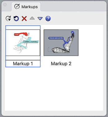

The Markup mode is a way to store view dependent feedback in your 3D model. You can draw, callout and annotate directly on the view using the tools provided. It can be restored, edited and exported as an image file (ex: JPG).
As a convenience each markup stores a screenshot of the view at the time of creation so future changes can be tracked.

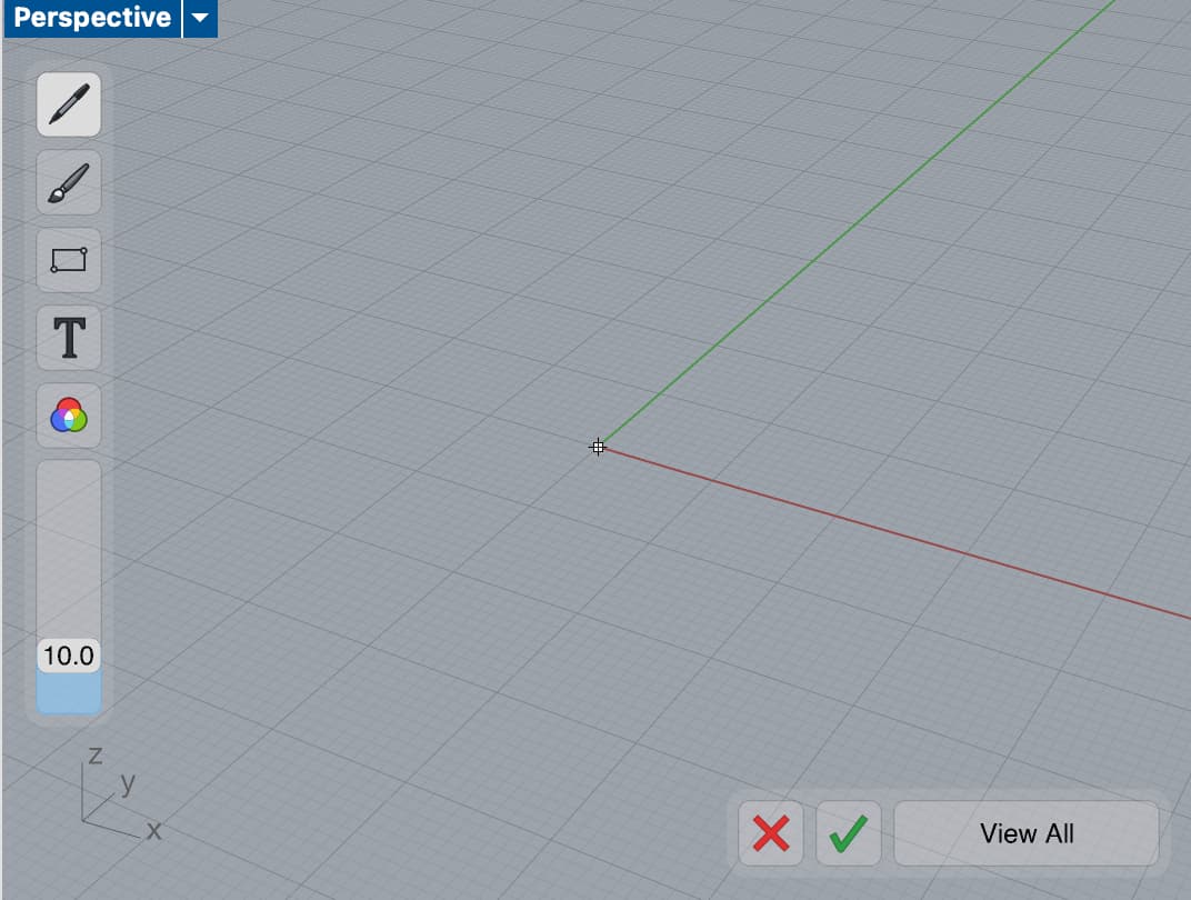

To keep focus in the viewport and the commands panel, most of the command options are accessible via the HUD. This is a new type of UI we’re trying out in the Rhino WIP for some commands. Feedback in this area is also appreciated.
This is very nice
the HUD is very comfortable to use.
a couple of early comments:
It will be faster i feel if color selection [Vis the HUD] will not require an Enter to accept
[using a Wacom pen here,] it will be much faster to change colors that way.

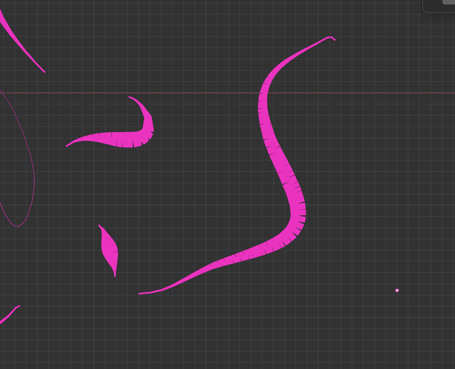

the tapered lines get a broken fill on tight[ish] curvature.
[is there a way to improve that via settings ?]
Any chance of adding brush pressure? [tapered lines are ok for a mouse. But with a pen, pressure sensitivity is, as you know, much more versatile and useful]
if possible yes.
Since this is only for Markups, one likely just want to quickly scribble stuff and quickly change colours… and a precise shade is perhaps not that important .
I means : if you change colour from the HUD only. There is also the option to pick colour from the command, [regular rhino paradigm ] and this can stay as the regular colour palate behaviour.
Yeah, double clicking on a color should close the dialog. There’s no option to make it auto close otherwise. Not sure if it should ever auto close if you are clicking a color wheel or slider as one would usually use multiple to select a color.

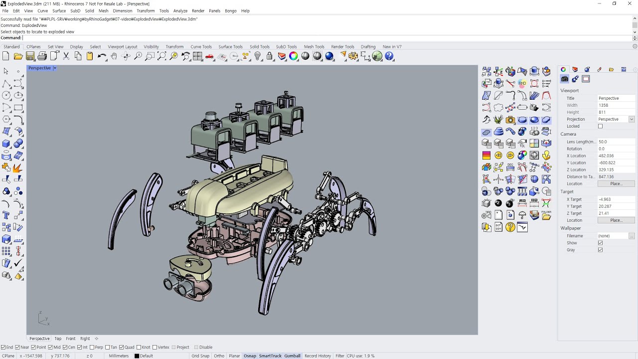

Basically all tools used for drafting, dimensions, hatches, leaders, line types, clipping planes and visibility state. Maybe this could be an excuse to have an official exploded view too?

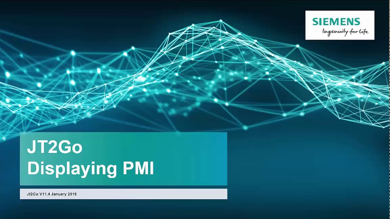

On the long term, allow to have Rhino export PMI data to some free viewer for the operational workers to use it similar to what we use JT2Go and Navisworks Freedom today on the shipyard. (I wish I had an iPad or iPhone to be able to test iRhino).

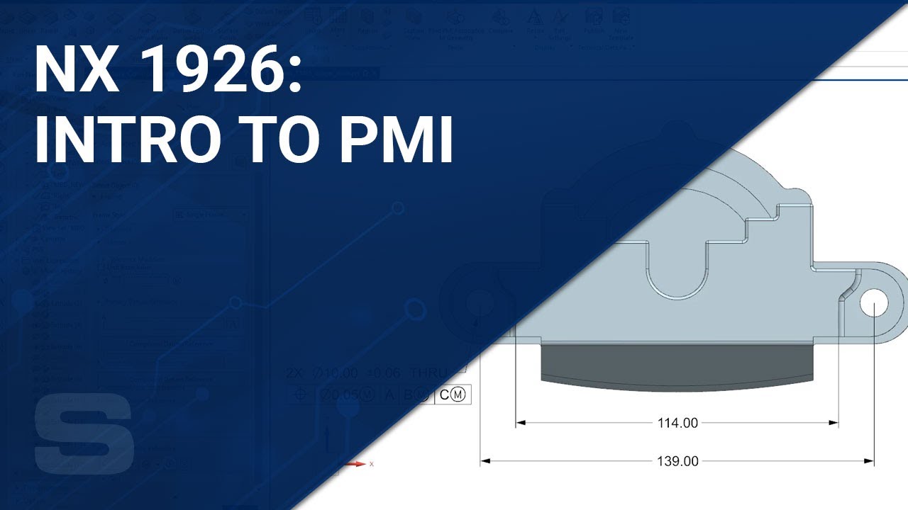

this short video of JT2Go show what the final long term objective would be. But on the short side.
This one a bit longer show the process of preparation of the PMI
If we had a Rhino viewer only version that didn’t require any sort of license to install on windows would be cool too. Because most of the workers on our shipyard have Windows Tablets but our IT department won’t allow installing trial versions for them because they think we would be abusing the Trial of Rhino and are afraid of McNeel taking legal actions. But this would be another thread subject.

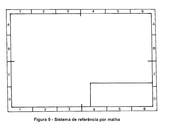

Yes, see image below as example of what I meant, basically being able to have legend and BOMs list and this kind of stuff on some views. It would be almost if the block was an overlay on top of the view.
In summary, it would be almost as if the layout space and model space became one thing and being able to export it as step 242 for clients to use their own tools.
Have you tried snapshots? I looked at the video you posted and seems like full control of every aspect of the model is what you need. Snapshots gives you that.
These two solutions have one fundamental flaw. It changes the model position, so this is not an exploded view, this is an exploded model.
So if I use this to create drafting, I have to rely on “static drawings” a.k.a. Make2D.
Unless the detail window could select different model positions for each detail, that make this unusable in my workflow.
Yes I did try snapshots, but the file becomes too heavy to quickly to the point that I have a few files I can’t even use anymore because trying to activate one snapshot different from the one that the file was saved with just crashes Rhino.
Snapshots are also bad for this solution because everything you create after saving an snapshot needs to be updated manually one by one afterwards, so it doesn’t allow the workflow to flow correctly when you have revisions.
