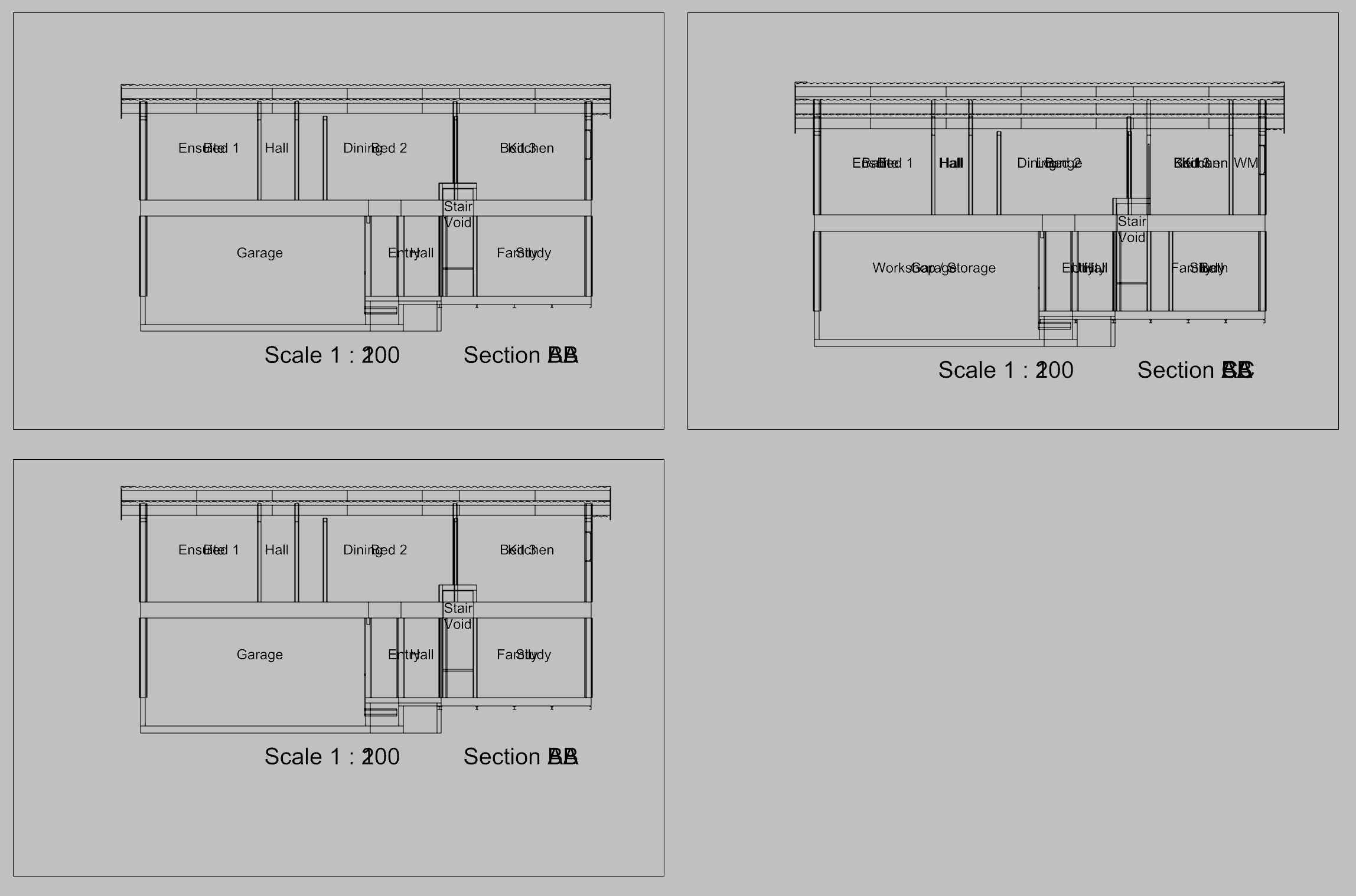

Rhino V8 is misbehaving when copying and pasting Details on a Layout.
After pasting, I would normally drag the new detail to a vacant position on the layout. After dragging, the new datail is empty.
I then use Ctrl-Z to undo the ReplaceDetail, Ctrl-Z to undo the drag, then Ctrl-Z to undo the paste. At that stage, all details are corrupted.
That means that there are 2 problems: the empty paste and the undo corruption.
The corruption is probably related to Rhino 6 layout corruption - #4 by coffsoft which has been awaiting attention for 9 months.
Version 8 SR12
(8.12.24261.13001, 2024-09-17)
Commercial
After Copy Paste Drag to create and position the copy of the Section CC detail…
Showing the empty new detail…
After the first 2 Ctrl-Z actions…
After the third Ctrl-Z action…
SysInfo.txt (2.5 KB)
KDRDetailCopyProblem.3dm (2.3 MB)

Hi Garry -
Thanks, I see that here → RH-83914 Undo: Changes Layer Visibility in Details

@wim I know why the new detail is empty. It is because I had turned off New Detail On for all layers. However, to be a truly useful feature, this new setting should relate only to genuinely NEW details, not to copied details. I think this deserves another fix request.
Yes. It looks like this was recently fixed for copying with the Gumball or with the Copy command, but not for the Ctrl +C & Ctrl +V workflow.
→ RH-83927 Detail: Copy Should Keep Properties

@brian Thank you. That part is working as expected. I will keep this open pending RH-83927.
