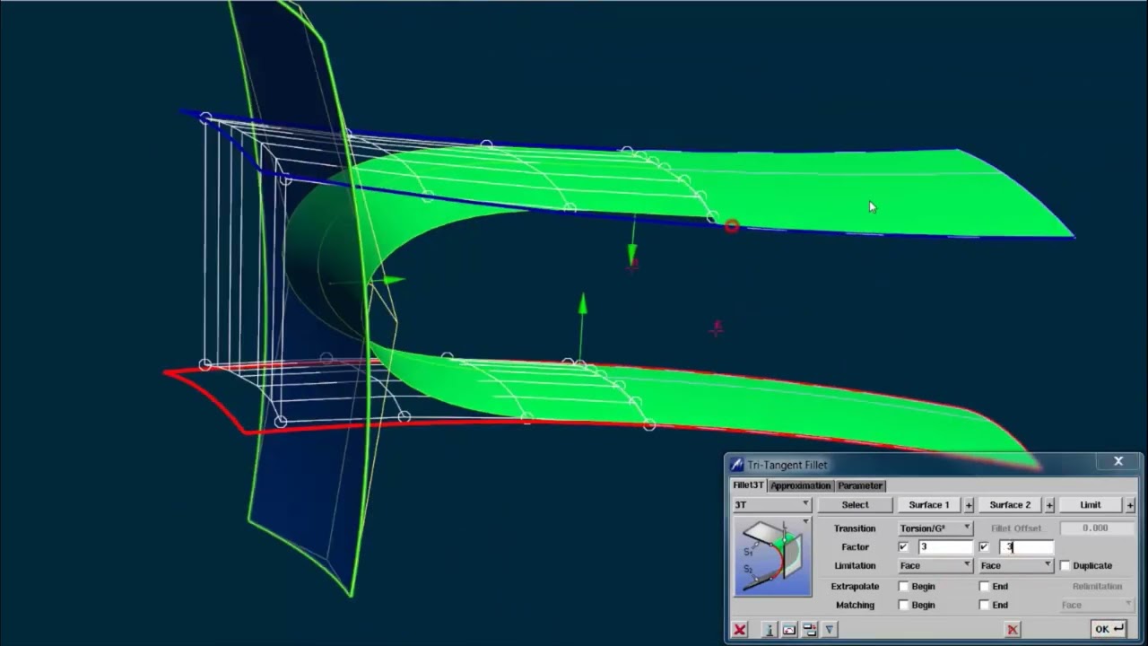

Just a little inspiration for the Rhino developers. Notice the “Tri-tangent fillet” shown after the 2:42 minute of the following video:
Note that the tool is capable to maintain G2 continuity at either end and the resulting blend surface still touches the target surface.
I can see this also being implemented as an option in the “Blend surface” tool called “Target surface”.
Also, check the magic that happens at the 29th second of the video above. Takes just 1 second in ICEM with its automated tool “Corner blend”. It splits the input surfaces in a very natural way and builds a single-span, high quality surface. Typically the same operation in Rhino takes minutes to do it properly (plus a lot of mouse clicks). :smiley:
Not to mention the line handles behind the arrow handles that serve the purpose of moving the entire row of control points gradually, while keeping the tangency of the opposite end intact (meaning that it adjusts all control points but the last two ones).
