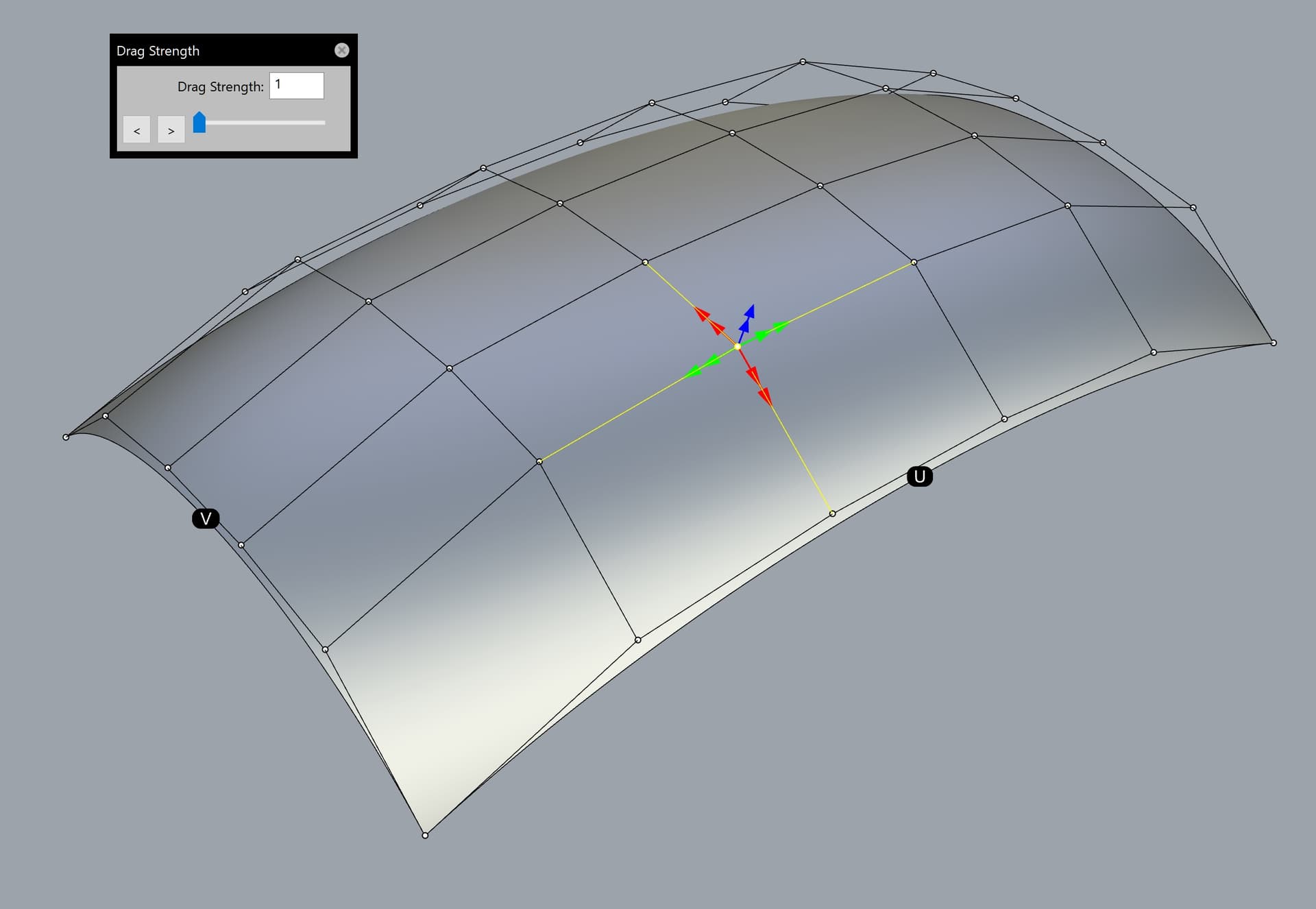

Attached here is a Rhino 7 3dm scene consisting a single surface with a proposal for a dedicated “CP Gumball” (control point Gumball) for convenient control point manipulation. You will notice that the arrows are colour-coded based on the U and V colours, and oriented along the control polygon of the selected surface control point. There is also an additional blue handle for moving along the normal direction. The idea is that when the CP Gumbal is active, Rhino’s current default Gumball should be deactivated.
CP Gumball.3dm (230.2 KB)
This is based on the “Super Gumball” idea proposed in my earlier posts in this topic.
Here are some more details about the CP Gumball:
  1. When the CP Gumball is active, moving the selected control point will be free in any direction along the imaginary control polygon (4 flat planes based on the respective couple of control polygon vectors). Alternatively, the control point could be moved along the common average plane based on all 4 vectors of the control polygon surrounding the former.
  2. If two or more control points are selected simultaneously, dragging any of them will move all control points simultaneously along their respective control polygon.
  3. There are two arrow handles in any of the 5 directions. Dragging any of the inner handles will be at normal speed along the corresponding control polygon vector.
  4. Dragging any of the outer arrow handles will act as a “Drag strength handle” automatically set to 5 for the current Rhino session. Note that when the “CP Gumball” is being activated, the Drag strength’s pop-up window should open automatically and be set to 5 (as mentioned above). The user could change that value afterwards. The default value could be customized from the Rhino options, in case that the user prefers any other value as a default instead of 5. Having dedicated “Drag strength” handles next to the normal speed handles will significantly improve the workflow of the users by saving time and reducing the mouse clicks.
  5. “Drag strength” must be upgraded to allow entering a value lower than 1 (such like 0,1 or even 0,01), because the current implementation is too limited in that regard. Take for example the “MoveUVN” tool which has a dedicated button for up to 0,001 units, but clicking on the tiny “down arrow” against “Scale” could further reach even stricter values such like 0,0001 or 1E-14 units.
  6. The user must be able to customize the size of the arrow handles (similar to the customization of the default Gumball), as well as whether the triangle arrows will include bars starting from the control point, or not (just a tiny triangle handle with no bar).
  7. There must be two dots along the middle of the positive edge of any surface with visible control points, named “U” and “V”. This is self-explanatory. They could be either black with a white letter inside, or coloured in red and green for a greater visual distinction (or any other colour combination set by the user). Furthermore, these dots could be shown upon running certain commands related to UV direction, such like “Extract isocurve”, “Dir”, “Rebuild”, “Rebuild UV” etc.
I just added some extra text to my last post related to concerns about the “light up Christmas tree” (crowded Super Gumball). :slight_smile: The easy solution is to simply Ctrl+click on the “Gumball mode” icon (where the white circle handle is located currently) to toggle between the blank default Gumball and the far superior Super Gumball. Problem solved with a single mouse click! :slight_smile: Those who will hate the Super Gumball simply won’t press Ctrl+mouse click on the “Gumball mode” icon.
Clicking with the left mouse button on the “Gumball mode” will cycle between the the proposed Gumball modes: World, Control polygon, UVN, View, CPlane.
Note that in my example about the optional secondary handles for “Drag strength” are only activated by holding Ctrl and clicking with the mouse on the “Gumball mode” icon (replacing the current white circle). Less advanced users who just want to use the current most basic Gumball handles don’t have to do anything.
My proposal is based on years of extensive use of various custom methods for control point manipulation in Rhino. The lack of such tools in Rhino is one of its weaknesses compared to programs like Alias. All the drag modes in the current Rhino are flawed to a certain degree and are unusable for a proper control point manipulation.
Not to mention that the “Drag strength” itself is limited to a minimum value of 1, which is not enough for a precise adjustment (especially from a longer distance where the drag strength factor is vastly increased). For example, if I work on a large surface such like car door or any other type of product design, I want to see the whole surface while using “Drag strength” at its minimum value of 1. However, since the camera is about 1-2 meters away from the control point(s), the set value of 1 becomes an obvious obstacle that will not let me apply a fine adjustment. In this case, being able to set a value of 0,1 or 0,01 would be welcome.

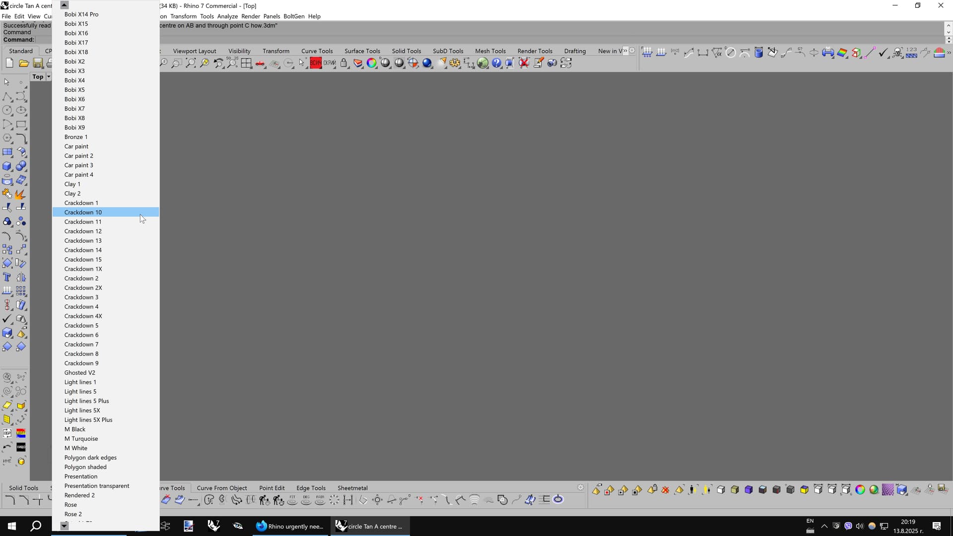

Yet another proposal related to the display modes. This time, it’s about the ability to select a display mode in a very convenient way. The current implementation is quite restricting, because the display modes are listed vertically along many other options in the same pop-up window, eventually leading to a massive frustration due to the inability to directly see and reach some of the later display modes.
The right side of the picture shows how a more convenient implementation should look like. Just below the default display modes there must be “More display modes” or “Custom display modes” menu, which could expand an additional pop-up window consisting only the names of all the extra custom display modes. Rhino should be smart enough to expand horizontally the pop-up window based on the number of display modes. For example, 20 display modes could fit in a narrow pop-up window, but 150 display modes will require a much wider window. Once the width limitation is reached, small triangle arrows should appear at the top and bottom of the extra pop-up window to enable vertical scrolling of the list with display modes.
Note that this new implementation will require far less time and mouse clicks.
That functionality is already implemented for other options inside the same pop-up window, so it’s up to the developer’s desire to enable it for the display modes, too. :slight_smile:
Also, fix the bug that lists the display modes in an unnatural way. Currently, “Display mode 2” is shown below “Display mode 10” despite being a smaller number…

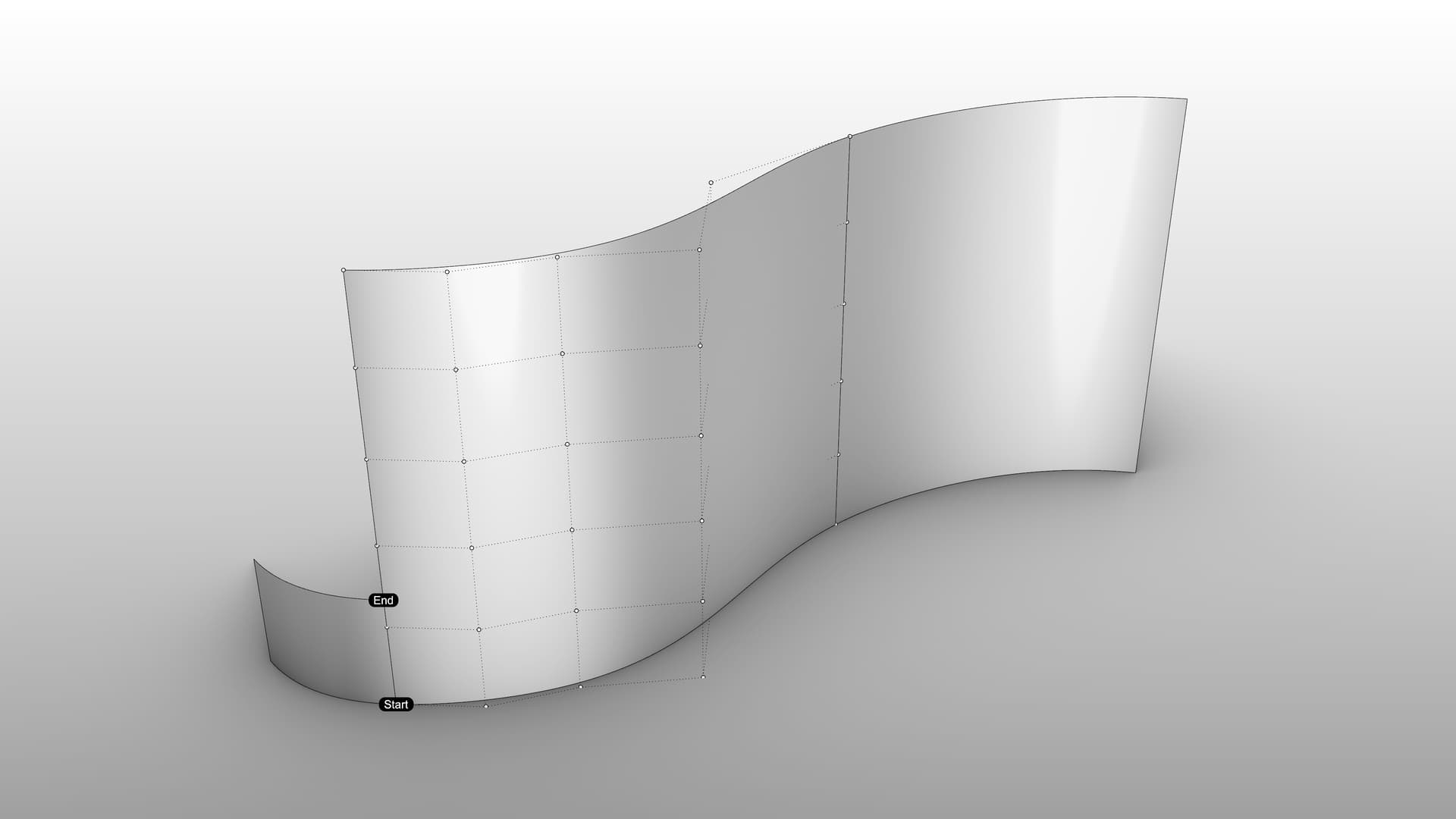

“Partial matching” is a much needed option for the “Match surface” tool. It will ask the user to pick start and end points to define the partial region that will be matched to a target edge or curve. The rest of the edge to be matched will follow the matched region in a natural way. The goal is to be able to match just a portion of the surface to be matched.
A similar approach with a partial region is already used by the ! _EndBulge tool.
Rhino could use some “hacks” under the hood to do the calculations, such like an invisible extending of a copy of the target surface edge or curve.
Partial matching.3dm (270.9 KB)
