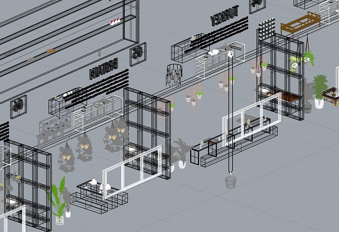

This is a particular file? Can you upload here? If its too large you can upload privately here, just put a link to the forum post in the comments.
Ok, I have uploaded the file privately
I was able to open up the file on my windows machine, haven’t tried on the mac yet.
Its a very large file for the information being conveyed.. 3.2 gb.
Only one BadObject (use SelBadObject command)
I’m going to purge materials and blocks and look at the geometry to try and lighten it up a bit.
Ok thanks for the update
Did the file manage to be opened on the mac?
The majority of file size is in these objects. I’ve split these out to separate files and will send shortly, you can insert as a linked block as needed.
great thank you
SelDup command found 42182 duplicate objects.
There are also 100000 plants that can be pruned. These are really slowing down the viewport. Replacing with a lower resolution object is recommended.
Rhino can handle of these imported objects up to a point, then you need to be judicious on what you are bringing into your file.
The overall goals of the project are important in this regard.
You should receive a link to the files shortly.
