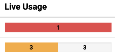

Hi Robin -
“Seeing license usage” by all members is on the list as WWW-1547 but would only show something like this:
… and not show names of other users in the team.
Feature request WWW-1182 is on Will’s list to create a new member / roll class for teams. This is currently on the “Future” list and permissions are not completely defined.
