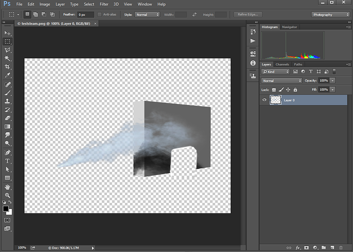

That is very close. If you look at the image in this post, you will see an object in front of the block. I want to assign the front block a material setting so it will “Cut” into the back block and leave the alpha channel.
I don’t think that’s possible… if a way occurs to me, I’ll post it.
I would not try to pre-mask any of my output. Instead, I would put a layer on top of my block layer in the compositing app, and let it be hidden that way. This is super simple in After Effects (or Photoshop.)
Now, if your layers are not currently configured to do this, I would guess you have a background element that you want to ‘show through’. That’s too hard. Instead, take that background element and break into two parts: foreground and background. Now, you have a piece to go on top.
