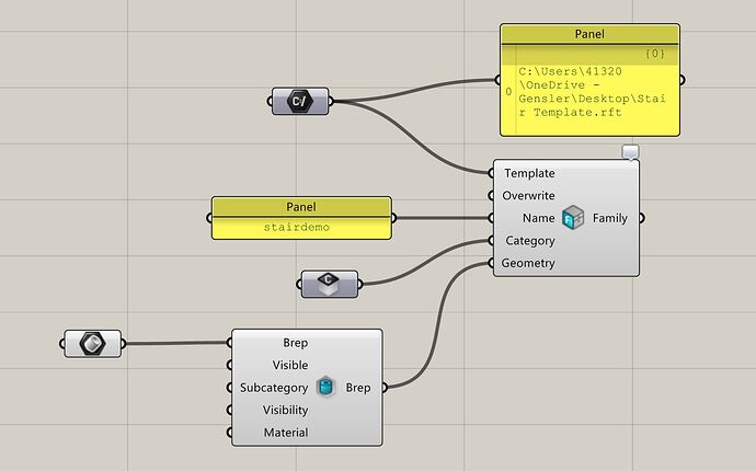

Hello Japhy, I set this example up as a way to vet the issue. My actual project is a set of stairs that I would like to bring in. So as I understand I need to use an add family component and create a custom stair template for that component I can see how to do that here: (11) Create custom family templates in Revit using Rhino.Inside.Revit - YouTube
Is this correct? I am testing out some things now I have this laid out below
The Add Family seems to take issue with the Built in Category picker. Am I on the right track? I think I am suppose to use a ā€œModel Category Pickerā€ for the Category input but I can’t find that component.

OK I added a family with my geometry successfully.
I am still unsure how to instantiate it in Revit with a material. Is this the right track?
Nice. Now open the Family and Add a new family parameter set to instance.
Then in the family select the Geometry and associate the instance family parameter.

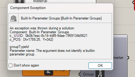

Hi Japhy,
I’m revisitng your method, which I actually would prefer to add a ā€˜Materials and Finishes’ Paramater as a Type Paramater, within the Identity Data of Rhino imported geometry into Revit.
I’m going to attach my grasshopper script
draft.gh (16.1 KB)
, and would really appreciate you or anyone within the community to chime in! The sad thing is I’m getting an error for the Build-In Paramater node. See attached. image
so I’m not able to finish this definition that @oliviamorgan20 began.
Does anyone have a complete script for RhinoInside, importing direct shapes with Material Paramaters?
Alas that is not a feature available in Revit. Here are some additional details about DirectShapes.
