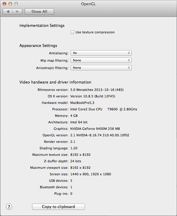

I am not able to duplicate this. Please post your OpenGL settings from the OpenGL preferences panel.

this is my Open GL settings

I see you have both an external display and you have anti-aliasing set to 4x. Both of these require extra graphics memory. Your graphics chip has 256 MB of VRAM and you are likely overtaxing the video memory requirements.
Try reducing the anti-alias setting or setting it to None, unplugging the external display, or closing the laptop lid (to turn off the laptop display) and see how that affects the problem.
