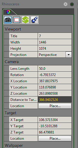

This is just a crop of a screenshot someone posted earlier in this thead. I don’t have this scheme to share, sorrry. You would likely have to change colours in your global Windows scheme to acheive a similar effect, as the Layer Background colour is hardcoded afaik, also in Rhino 6.

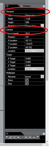

Do you have any idea what controls this area? Yours is not default…
I’m so close to greatness…

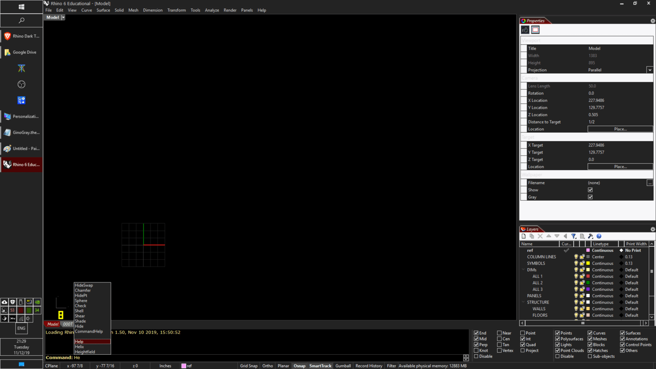

i am on win 7,
here it is this :

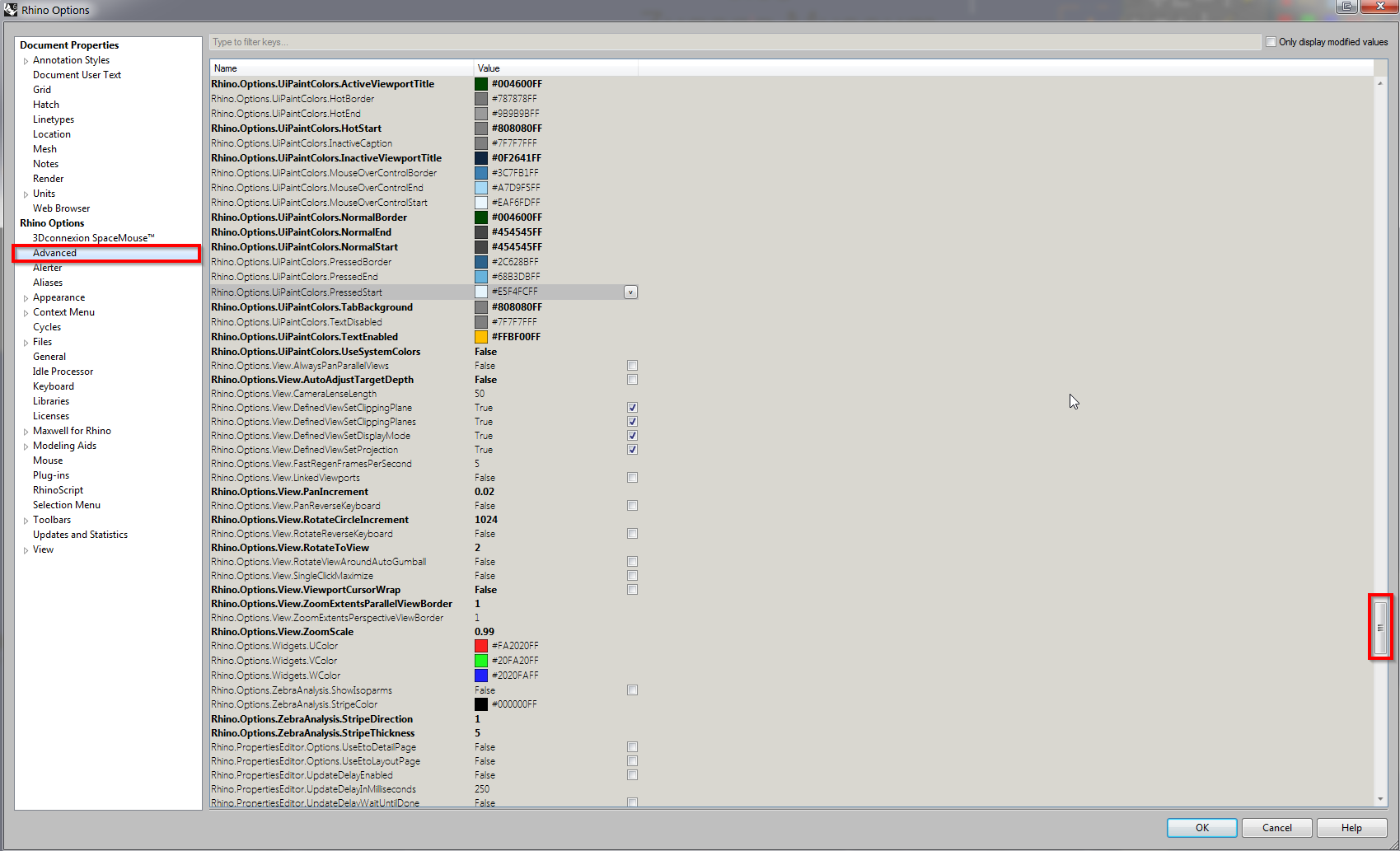

Hi @dk2079
How do I get these options to change colors ?
Thanks :rose:
