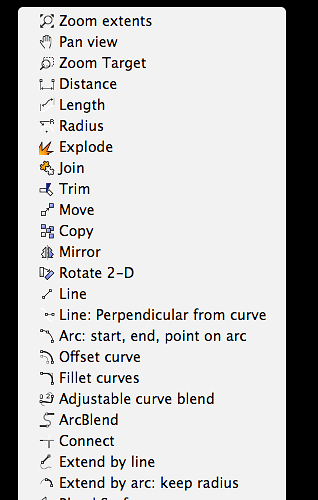

How about adding the 4 viewport types to the Right-Click menu in the viewport? Just under Repeat.
Perhaps the easiest and fastest way to switch when in a maximized single view. Personally that would be what I would use viewport Right-Click for the most along with Repeat and perhaps shade mode.
you can’t use that context menu while in the middle of a command or with items selected… which, for me at least, is often the times when i switch viewports.
i suppose i could think ahead a little more and recognize i’ll need another view prior to starting a command or making selections but i’ve fallen back on not worrying about it since i can just click up top on an as realized basis.
(edit) or- i suppose the viewport options could be added to all context menus? even though it may be out of context in many scenarios.
Good point Jeff. I suppose it would be pre-command only like shade modes at present. Could just be me, but I see the viewport right-click as good place to manipulate the viewport without loosing focus, similar to how the customizable middle mouse button (or other buttons in a 3+) has been a productivity boon when populated with one’s most frequently used commands.
My middle-button has 23 grouped logically to me.  Marlin - the ability to add a separator line would help my feeble brain a bit.
you can switch display modes during a command-- just not with the context menu… i use the control-command shortcuts a lot (S-shaded, G-ghosted, X-xray, W-wireframe)
i’m not really sure what you can do with viewports though… if i used a macro ' _Front ,it wouldn’t change me to the front viewport… instead, it would change my current viewport to Front settings.
i don’t know… i haven’t really investigated the options for this… i just use those buttons up top.
