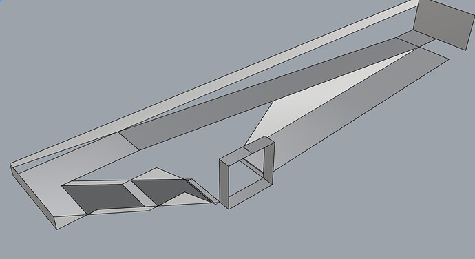

Rhino can't handle simple offsetsrf

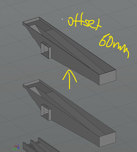

Planar surfaces only, Offsetsrt solid yes fails unlike in microstation:
in rhino:
terrible
I feel like rather simple cases like this should be managable in rhino.
bad offsetsrf.3dm (175.3 KB)

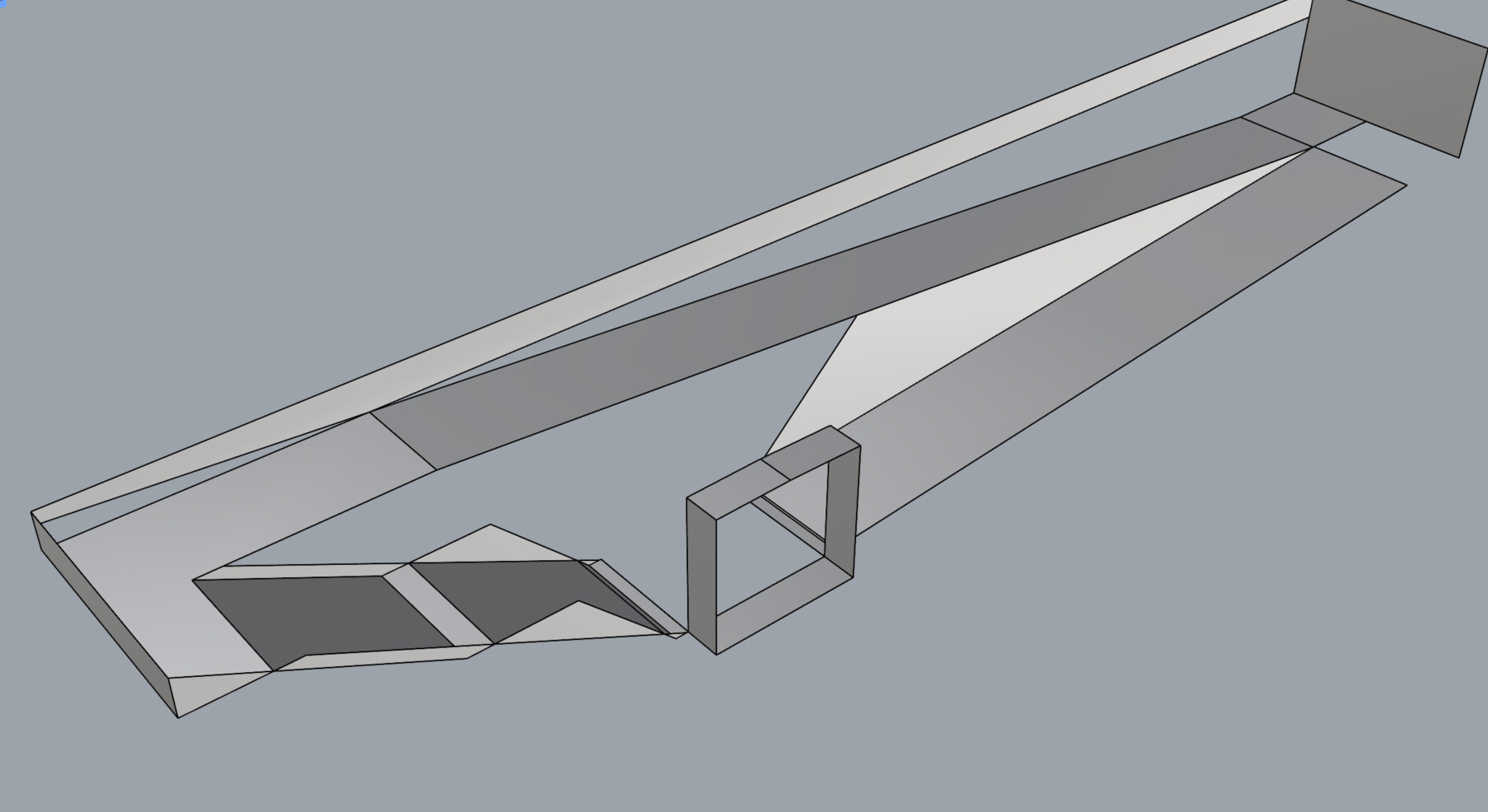

Works with round corners in Rhino 9.
i need sharp, is the result different from rhino8?
I can’t try in Rhino 8 right now.
For sharp corners, likely the small zones near the bottom exit are problematic
offsetsrf_round_9_8.3dm (550.1 KB)
If you cap the two openings (holes) to make a solid, and then do the offset, it works.
Hmmm, there is an issue with the offset, even though Rhino indicates the polysurface is valid
