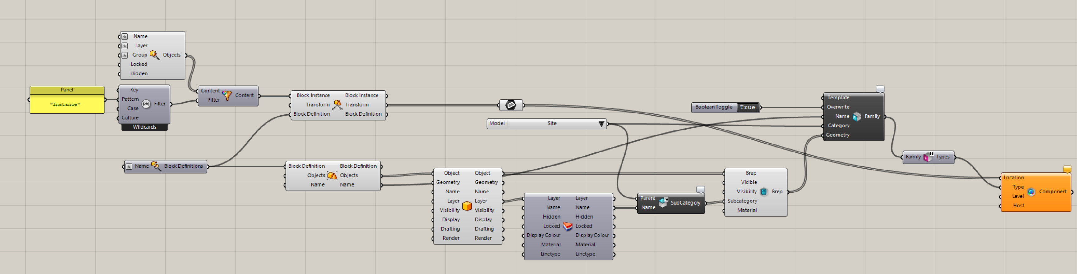

What I meant to say was that Rhino 8 has built in tools to deal with blocks. So it would be a good challenge here to try and solve this that way. I will take a closer look.
Here is the way to get Blocks to Families using Rhino 8 components.
Generally the Block instances and the block definition are both used.
All the geometry of the block definition is extracted and placed in a Component Family. The block definition is always located at the 0,0,0 Origin. In this case the layer names are cub categories in Revit.
Then the Instances are found and used for the insertion location of the Family/Type in Revit.
This is a lot of new stuff, so I expect there will probably be questions.
With these new components, how i would go about grabbing the layer info of the block instances? (not the objects inside the block, just the layer the block instance itself sits on.
Run the top block instance component into the model object component to strip off it’s insertion layer. In the current definition above I only used the transform from the component.
yer I had thought that however it seems to be throwing nulls.
