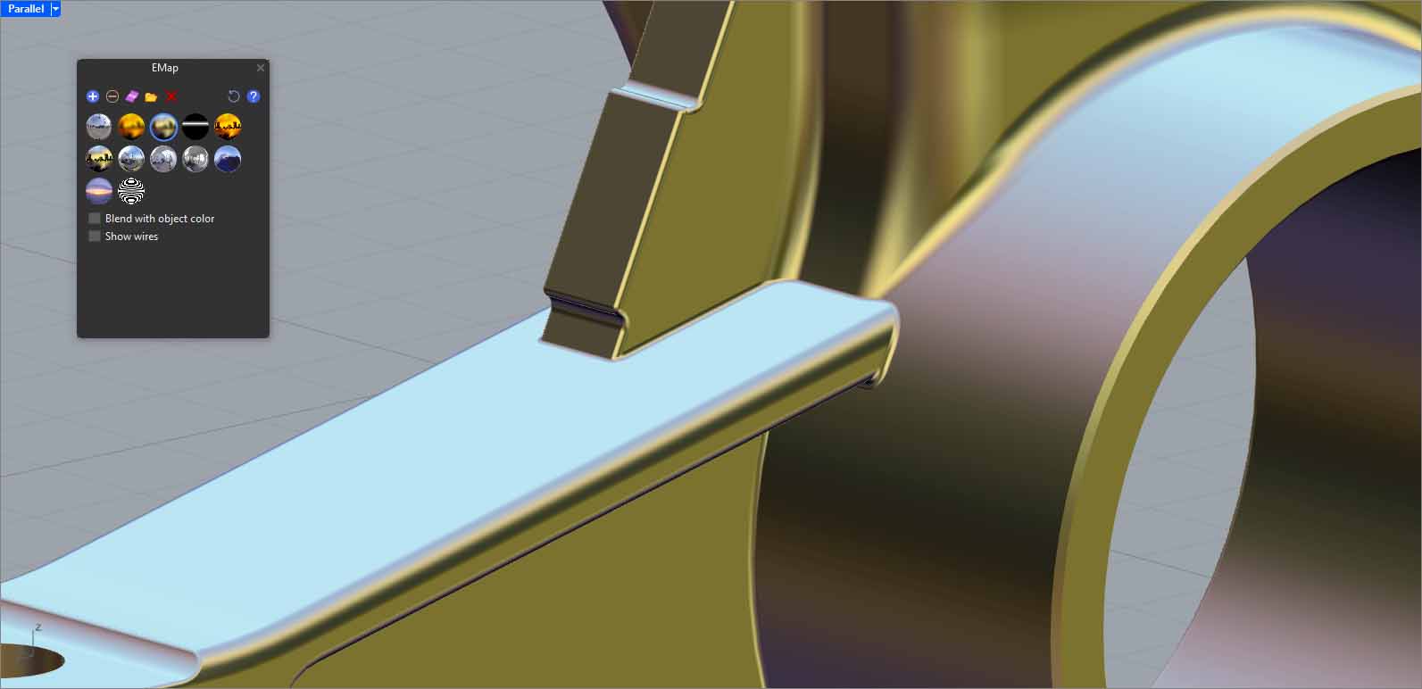

I wasn’t talking about the User tolerance. If you go to Properties> Details Rhino says the edge tolerance is .1. That means at least one edge is inaccurate by that much. Most of the error is in the 6.885 dia. hub. If you replace that with a true cylinder a lot of the error is fixed. Ideally you should start over and build the base geometry accurately.
A fillet is just a connection between two surfaces. Rhino Version 2 can make every fillet in the file I posted. Just click on the two surfaces and it will make the fillet that is a bridge between them. Rhino has been able to do this for decades. The best way to learn is by doing it.
I’m pretty sure that Rhino8 will make all the fillets also. But Rhino8 is not as good as Rhino6.
Rhino 9 seems to have fixed a lot of the regressions in Rhino 7 and 8 so I would recommend trying that.
The difficult part is the trimming and joining. When you have accurate base surfaces and accurate fillets then the trimming and joining goes smoothly. When you are working with sloppy geometry it can be a struggle. One of the problems in your file is that a few of the fillets end in a point. That’s something FilletSrf often fails to make correctly. You have to use SetPt to fix the point that FilletSrf fails to make correctly otherwise trimming and/or joining will fail.
The best strategy for using filletsrf is to think of it as strings of fillets that connect features. In the enclosed file I used different colors to show which features the magenta fillet strings are connecting:

The image below is marked with arrows showing several of the places where the fillets end in a point or what should be a point but Rhino fails to make the point correctly.
Those defective points can be fixed with SetPt.
