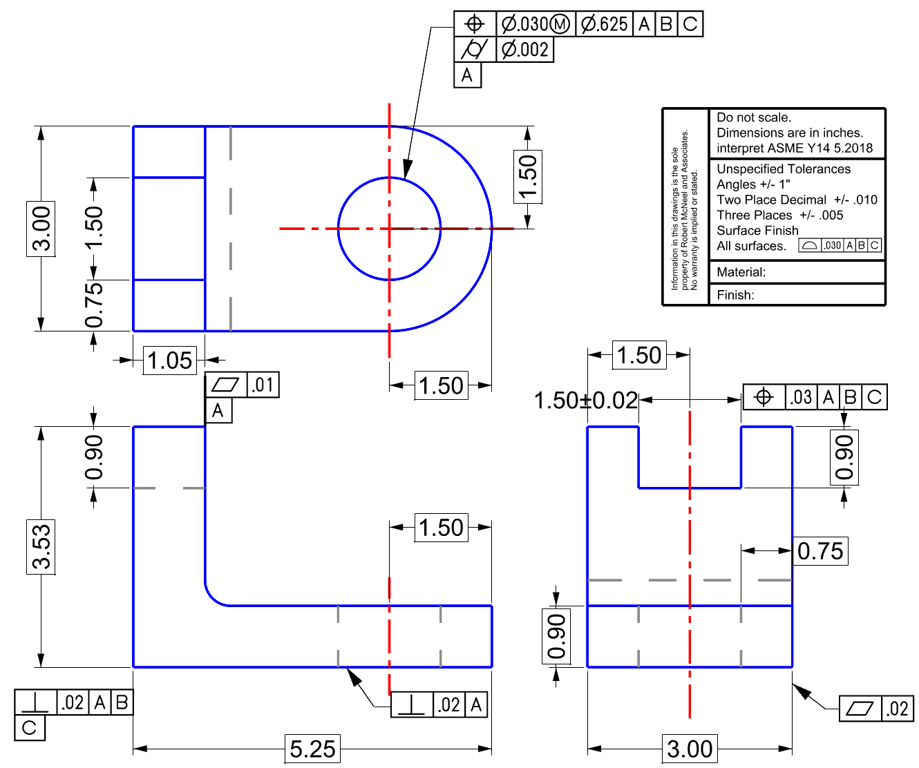

Geometric Dimensioning and Tolerancing (GD&T) is a system that uses symbols on engineering drawings to define and communicate the acceptable variation in a part’s geometry.
This ensures it will function as designed if manufactured to the specifications detailed by the symbols.
Here is an example of a GD&T Feature Control Frame:

See the geometric tolerance in use here.
