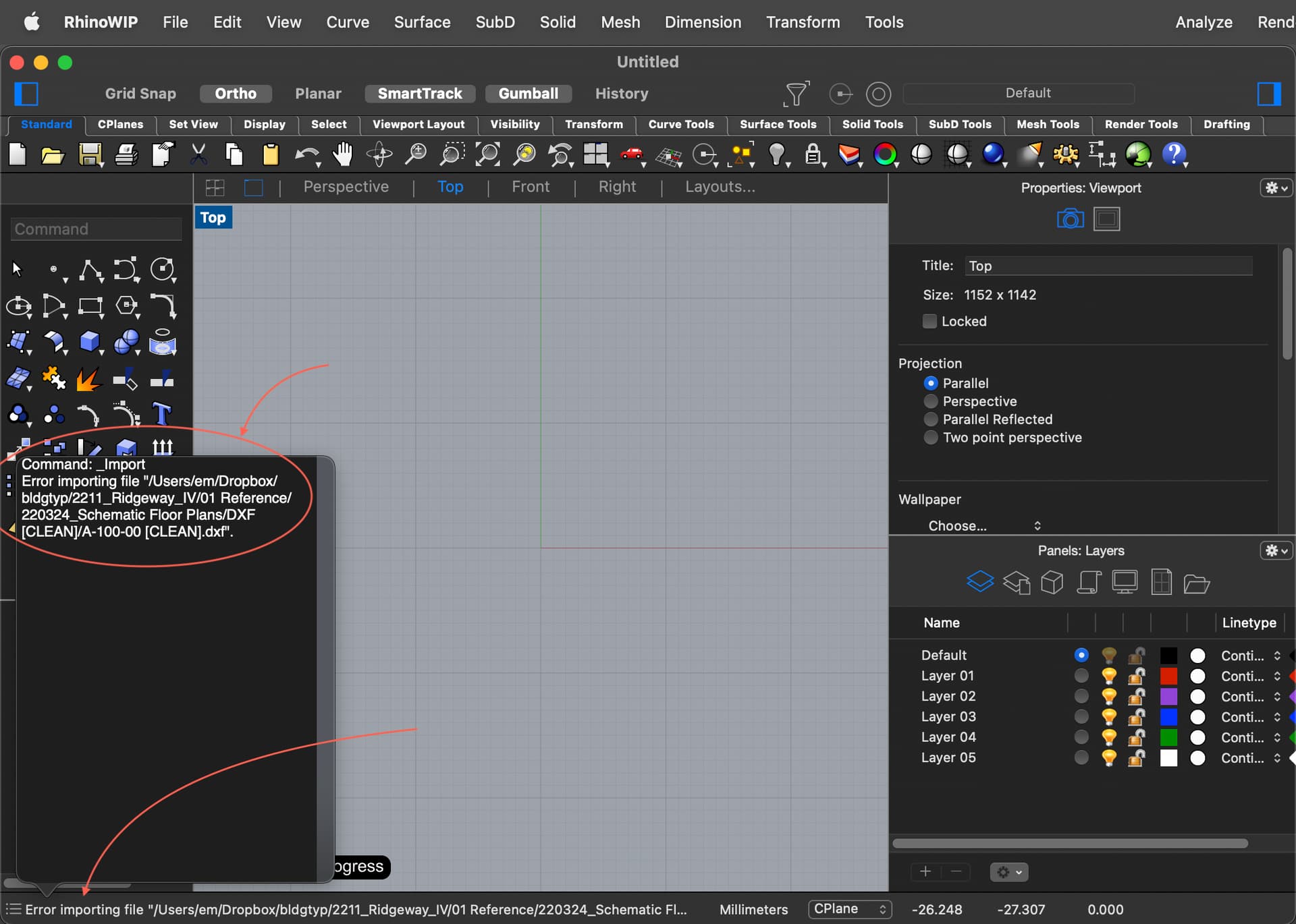

Just wanted to note a bug in Rhino 8 WIP on MacOS with M1:
If you try and “Import” a DXF file, I get an unspecified error:
File / Import…
Select a fairly small DXF (all flat, just lines)
Unspecified Error
Note also, the ‘Options’ button on the import dialog does not work either (so input for scale, etc…)
FWIW: this exact same DXF file imports perfectly well in Rhino-7, but obviously since Rhino7 is so, so, slow on M1 with lots of small objects (like CAD drawings) it would be great to be able to do the import and work in R8.
For now, the workaround is to import in R7, save, and then open in R8 to do what I need with the underlays.

You bet: I created and saved a DWG and DXF to my desktop, but still get the same “Error” message:
for reference, the DWG/DXF files are attached as well (just a single rectangle):

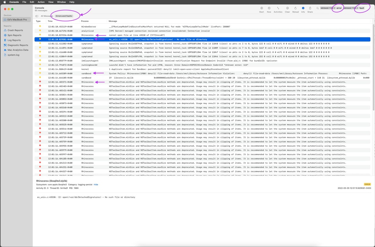

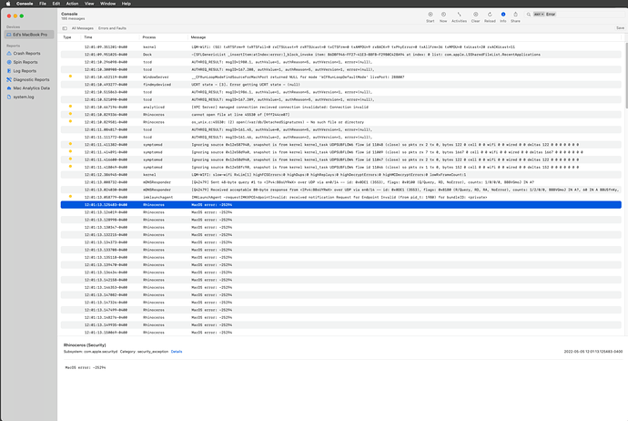

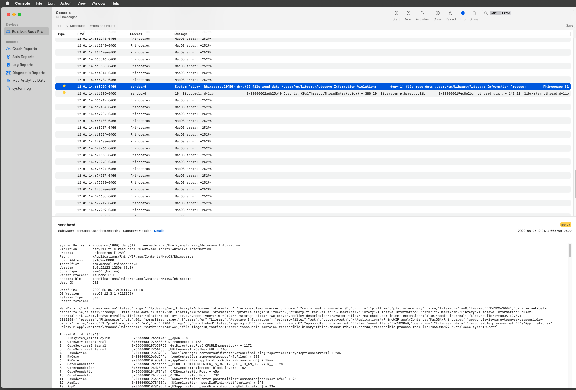

Hi @dan Thanks for taking a look at this. And yes you bet: happy to try that out. I closed everything else and tried to capture the Console sessions as quickly as possible while opening Rhino 8 WIP. So this is what it shows me when I filter for “Error”:
that “MacOS Error - 25294” goes on for a long while (all the same text). And then it does show one warning message that looks like:
and then when I click to ‘Errors and Faults’ I see:
I have done a full copy past of all 186 messages and attached here:
Console - Rhino 8 WIP Startup Full Error Log.txt (73.1 KB)
and all 65 Warning / Errors:
Console - Rhino 8 WIP - Error and Warning Full.txt (72.4 KB)
and then I copy/pasted the body from that 12:01:14.665209-0400 error as a separate txt doc as well, to hopefully make that a little easier:
Console - Rhino 8 WIP Startup Error 12-01-14-665209-0400 Error Log.txt (32.8 KB)
hopefully those .txt documents come through correctly? Just let me know if not and I’ll try again. If there is anything else from that I can provide just let me know and I’d be happy to of course.
