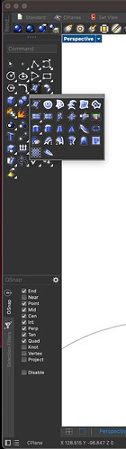

The Rhino 7 to 8 interface update will take a while to get used to, and it is fine, but there are a few settings that I really would like to maintain, or at least be able to set, and so far I couldn’t find how to.
  1. Delay for dropdown after click: annoyingly long. I tried to set it differently, relaunched afterwards, but to no effect.
  2. Visible name of commands: it is essential for me to have it. Icons are nice, but these are too many for not constant-use functions
  3. Popup box not persistent: behaviour in R7 > exit with mouse, box disappears. Behaviour R8 > exit with mouse, box persists until click away. It is “polluting”
R7 --------------------------------- R8 ------------------------

hi @Amebonini could you make a small screencap of what you are seeing?
logged as RH-78318 Global setting needed for popup toolbars

In Windows V7 and earlier, one could left click and hold to make a cascading toolbar fly out, or right click to bring up the pop up toolbar (neither of those are menus in Windows Rhino).
The difference is that in V7, once the toolbar was flown out, with the button still held down, you could mouse over to the desired tool and just let up. The tool would be executed and the toolbar/pop up would disappear.
In V8, that no longer happens. Once flown out, the toolbar/pop up stays out when you let up on the mouse button - until you mouse over a button and left click on it again to execute it. Then it will go away.

I was referring to these lines that divide the list in categories.
I think there are few doubts about how heavy the new dropdown feels.
R7---------------------------------- R8 ---------------------------------
Also in the R8 screenshot notice the misplaced “Fillet Surface” with left click icon hovering in the wrong spot? That is also persistent, but… very persistent. It stays up to a random amount until some trigger makes it disappear. At times it transfers over different application when switched. Not sure if this is a known bug as well, but I’ve been noticing it quite a lot lately.
Well phrased, yes, this
thanks, I just found out about it, logged as RH-78329 Popup toolbar with separators issues

I’d like to have something like the left part of the image
that is on the list as RH-78667 Wish: Option to fly out a menu instead of a toolbar

(https://mcneel.myjetbrains.com/youtrack/issue/RH-78667) was logged as a wish by Dale due to a post I made. But i believe there is a misunderstanding:
I was not wishing, I was pointing out a grave regression.
It is not specifically about having a menu INSTEAD of a Toolbar, but rather, the issue is about :
A) Having the toolbar viewed as a list with icons - this is yet only possible by resetting each individual toolbar by floating it, and then right-clicking the top of the toolbar to open properties…
  • having a global setting would be better
B) The toolbars should work SIMILAR to previous RH7 menues:
MEANING: Left click-hold mouse-over will fly-out sub-toolbars, and open the desired tool by release-click.
in total just one click would surf through the entire toolbar and sub-toolbar.
in RH8 one has to click two or three times to open to a desired sub-tool, AND you have to do it with very distracting info pup-ups, AND be able to hit the small corner arrows to cascade the sub-tool bars. This is tedious and counter productive, compared to previous versions.
AND … by the way … IF one click-opens the wrong sub-toolbar by mistake… Have you noticed how it is not really possible to click-close that sub toolbar again? One has to either click-close the entire toolbar and sub toolbar by clicking outside the toolbar, OR find another sub-toolbar to click open, because the one you where going after in the first time is now hidden behind the wrong sub-toolbar…
but if you click on another sub-toolbar, that closes the main tool-bar, and leaves only the second sub-toolbar open. … Its a mess. I end up clicking 5-6 times if that happens…
