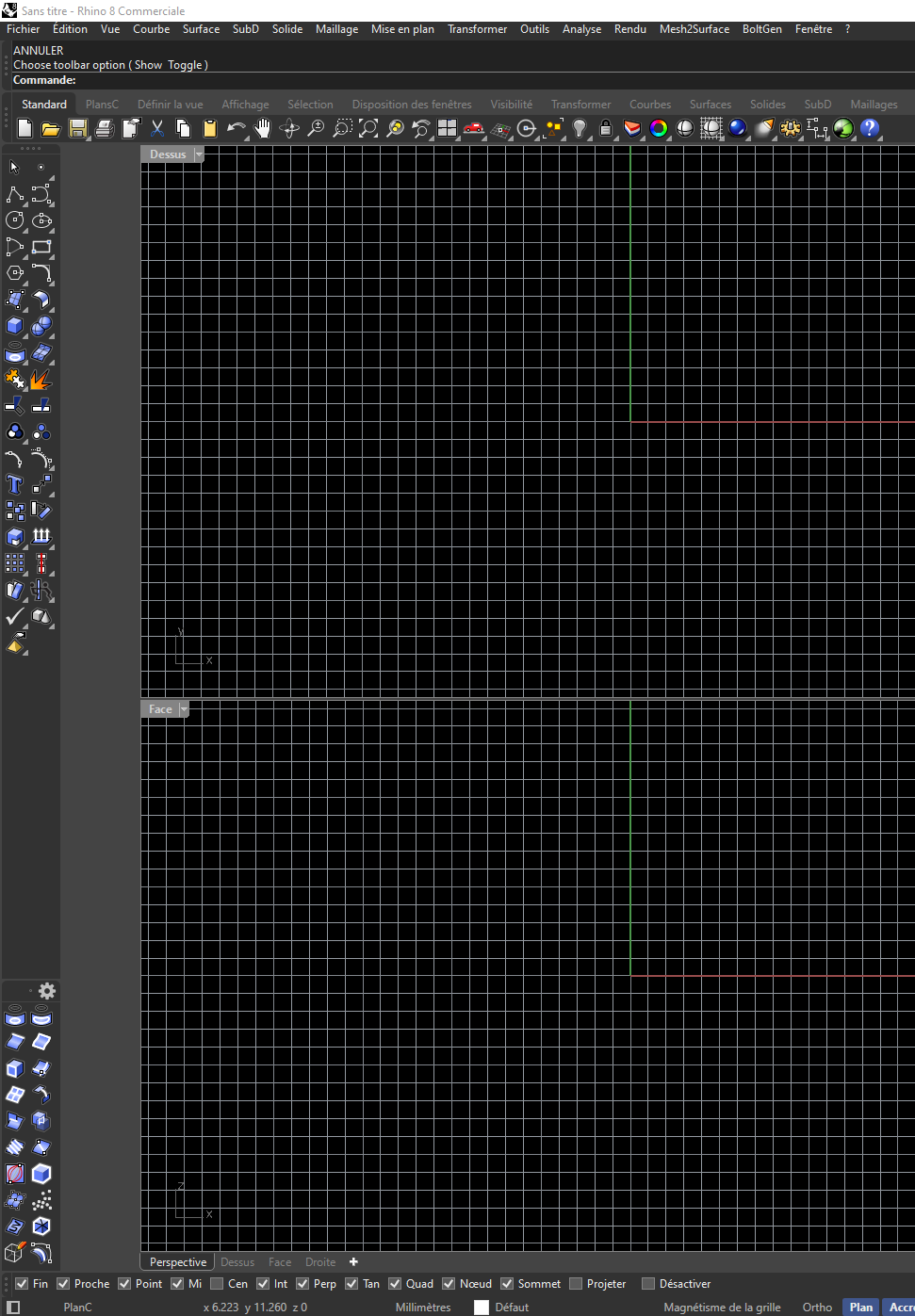

But it’s not perfectly functional like Rhino 7.
If the toolbar has been docked, the exact docking position is not remembered when the toolbar is recalled.
(Especially when docked next to the Standard bar on the left. At times, our toolbar moves to the right or left of the Standard bar. It should remain on the exact side selected. It does this very well on Rhino 7).
This is a real problem.
What’s more, when a docked toolbar is hidden (Show No), a phantom empty zone remains in place of the toolbar. See my illustration images.
This is a real problem too.
Hello- I see that, thanks.

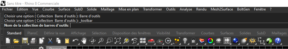

Another thing I just noticed is that the French _Toolbar parameter (Barre d’outils) of the -_Toolbar command does not work we have to enter the command in English for it to work.
Below is a screenshot to illustrate :
Hi Matthieu - thanks for the heads-up for the french command line option. Clearly a lot of errors in there.
RH-80914 Toolbar: Dash version command line options in French
