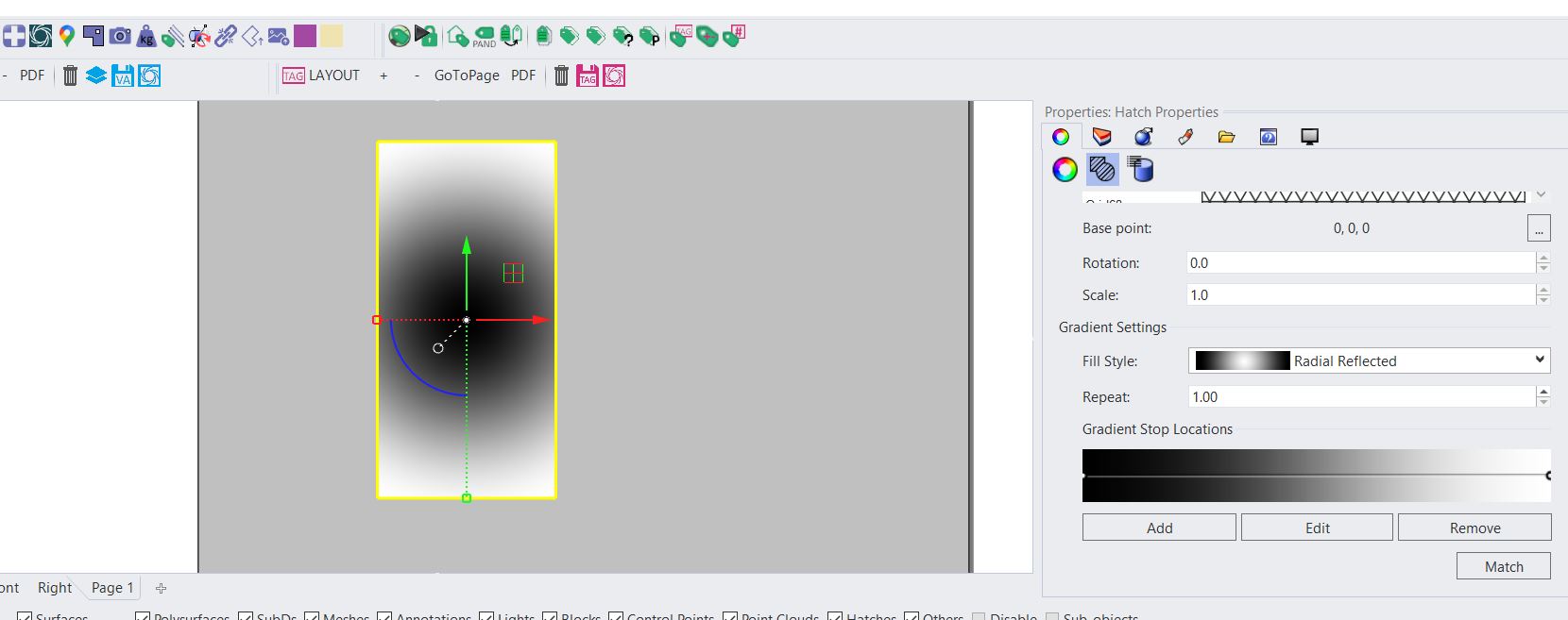

Hey I have some troubles with creating hatches in Rhino 7. Few days ago everything was working fine. I was trying to solid add hatches with python code, but nothing was added to the document, even though there was no error in the code. I tried to run same code in Rhino 6 and everything was working fine. I tried to reopen Rhino 7, open another file, switch on/off computer and to reinstall Rhino. Nothing worked.
Even adding hatches using rhino ui is not working. When I press ctrl + a to select everything I can see in the properties that hatch was also selected and I can play with it’s properties - It is just invisible. When I select fill style to gradient it strats to be visible for a moment, bat after deselecting it disappears. I tried to play around with different scales but it didn’t work.
Could anyone help with that? I feel I done everything I could think of.
Thanks in advance
PS I’m attaching few screenshots

Hatches are visible in the 3d space - I can draw a rectangle and apply hatch, but when I try to do same thing in the layout view it stops working (trying to add to the layout space not to the model space).
Do you have any ideas what could cause that?
Ok I finally found out what was the reason. A really stupid thing - my layout display view was by default set to wireframe. After changing to shaded solid hatch is visible also on the layout. Didn’t know that I can also change display modes for pages. Sending the printscreen, maybe someone in the future will have a similar issue. Thanks for your replies.

I’m glad that you found something that makes things “work” for you, but, just for the record, we recommend leaving layouts in the wireframe display mode. There is no reason (or, at least, should not be) to put these in shaded mode to see hatches that are created on the layout:
I still believe this is an issue with your GPU drivers.
