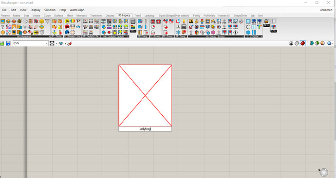

I’ve recently updated Rhino from 7.1 to 7.5. Unfortunately, after the update, Grasshopper doesn’t load all the plug-in tabs. Most of the plug-ins work but I cannot visualize them in the ribbon. Other plug-ins simply stopped working. In fact, when I try to run them typing a command in the canvas this happens:

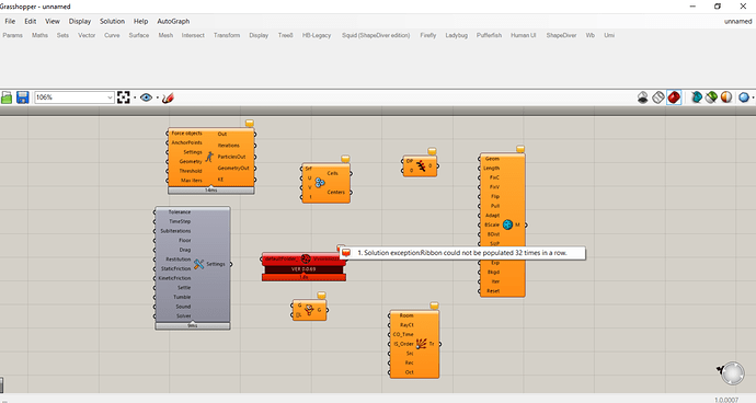

Furthermore, I get a strange error message from Ladybug: 1. Solution exception:Ribbon could not be populated 32 times in a row.
I’m attaching a screenshot in which you can see some components taken from the affected plug-ins
