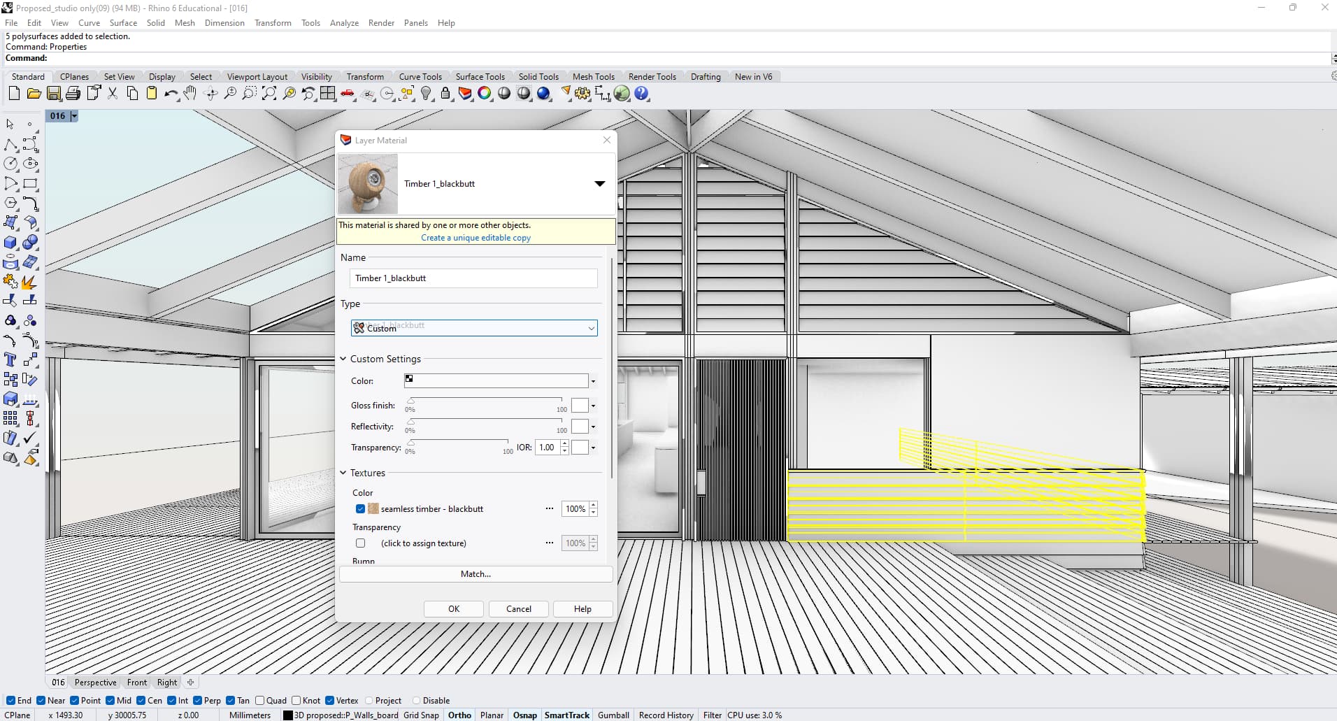

I’ve recently migrated onto a new laptop (processer is AMD Ryzen 7 5700U with Radeon Graphics).
Since then, everytime I open up a 3D file, it doesn’t load the material textures from earlier sessions (using Rhino Render). The material file paths are correct. And yet I then have to change the material, creating a new material with the same texture, in order to reload the material.
Save file then reopen and it happens again. Quite laborious and time wasting.

Interesting test result. When rendering using Rhino render, the image produces mapped materials. The model rendered view then updates and applies one of the material texture to ALL materials (in this case the silver roofing material).
Next step, I hit save. And all materials update (image below). Bizarre?
I’ve reproduced the same result on 2 separate complex 3D files and have had the same result - Open file, all materials missing, press save, materials reload.
So in effect the issue is resolved. However it would be good to know what may be causing this?

I’ve since updated the drivers and the opening problem still persists. Saving immediately continues to work though.
