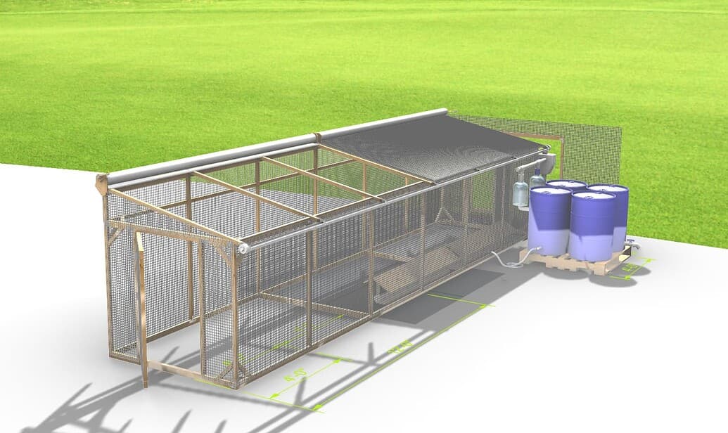

Rh-6 : I’ve enabled “Ground Plane” AND selected “show Shadows ONLY” .
What I’m HOPING for is to get :
an invisible ground plane
that works ,
is invisible ,
receives shadows ,
and that the shadows START at the objects . I’ve set self-shadowing to 0.001 to pull shadows back to their originating objects , and in Rendered mode “Default Lighting” they originate correctly , but in “Studio Lighting” lighting setting under RENDERED in viewport “Display Options” they don’t and seem to come in a bit light/dark wonky on the water barrels (blue) .
This USED to WORK correctly .
Rh-6
ANY real help will be WONDERFUL !! -
Thanks !
C.

The file was already uploaded for your earlier thread… I’ve posted the link to @pascal
Looks like in Rhino 6 and Rhino 7 the ground plane, even set to shadows only will show the background, but not objects or parts thereof that are below the ground plane in Rendered display mode.
The white that you see when turning on the ground plane with shadows only is the background color.
