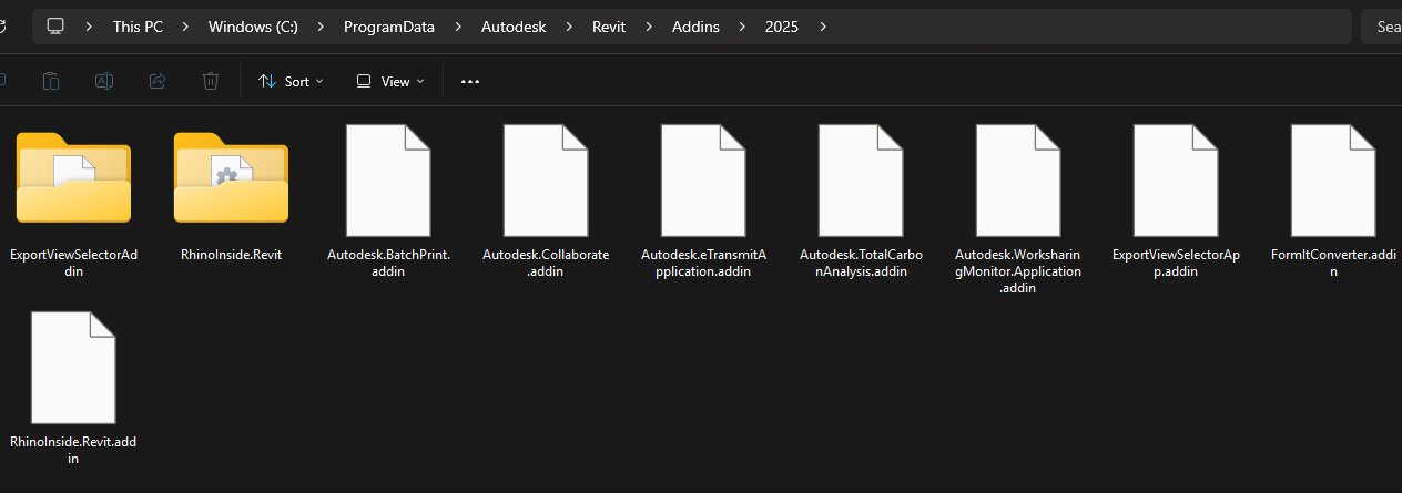

hello, I have the same issue as above,would yould you mind looking into that? here is the screenshot from the same directory,thanks in advance:

The screenshot looks proper, are you saying the RhinoInside.Revit folder is empty?
Hello, yes ofcourse ,I’ve updated everything btw in an attmept to solve the issue and had also removed all plugins to cross out any possible conflict:
