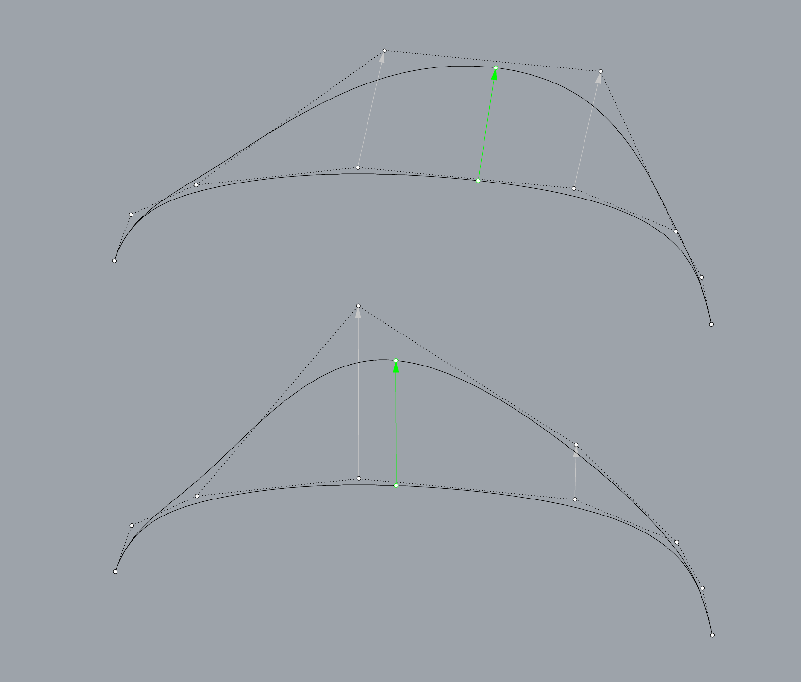

Request: Exact quasi-local editing of curves
Problem: I do not know of any simple proceedure in Rhino to edit a curve so that a point on the curve goes through an arbitrary point.
Requested solution:
A curve can be edited by selecting and moving a point on the curve. The point can be anywhere on the curve. When the selected point is moved to a new location the curve changes so that it continues to go through the selected point at its new location.
The structure of the curve remains unchanged (curve degree, knot vector, number of knots, number of control points, no additional multi-knots).
Oscillations/wiggles are not introduced.
The portion of the curve which changes is as local as possible to the selected point, with the position of only one or two control points being altered.
The parameter value of the selected point is unchanged after it is moved.
For multi-span curves a portion of the curve will usually not be altered.
An algorithm which satisfies this request will be described in a subsequent post.
A visual mockup with the green point representing the location on the curve which is moved. The resulting movement of two control points is shown.

if i understood that correct, the command you are looking for is called HBar, it will introduce a temporary handle editing point and will let you pick any arbitrary point on a curve to locate it exactly where you want without changing the structure of the curve.
there is also SoftEditCrv which works similar, though the target point will not be exact and somehow acts like a temporary control point rather, so HBar is i guess really what you would like.

HBar does what I want. I had forgotten about it, and it does not appear in any related Help files. :grin:
HBar works fundamentally differently than using edit points, which affect the entire length of the curve and almost always introduce oscillations/waves.

The HandleCurve command in Rhino creates a polycurve, with each curve of single span degree 3 curves. It is not a separate object type, just a polycurve. At the conclusion of the HandleCurve command Rhino does not know how the object was created (other than the Undo stack). Anything which works on polycurves works on the results of HandleCurve.
HBar works on any curve or polycurve.
HBar is what I was looking for.
My comment about edit points was to describe how modifying a curve using edit points gives fundamentally different results than using HBar. “affect the entire length of the curve” meant that when using edit points the entire curve always changes shape, not that the length of the curve changes. In contrast for a curve with sufficient number of spans HBar does not change the shape of the entire curve, only a portion of it. (The number of spans HBar affects depends on the degree of the curve and the position of the location where the curve was selected.)
