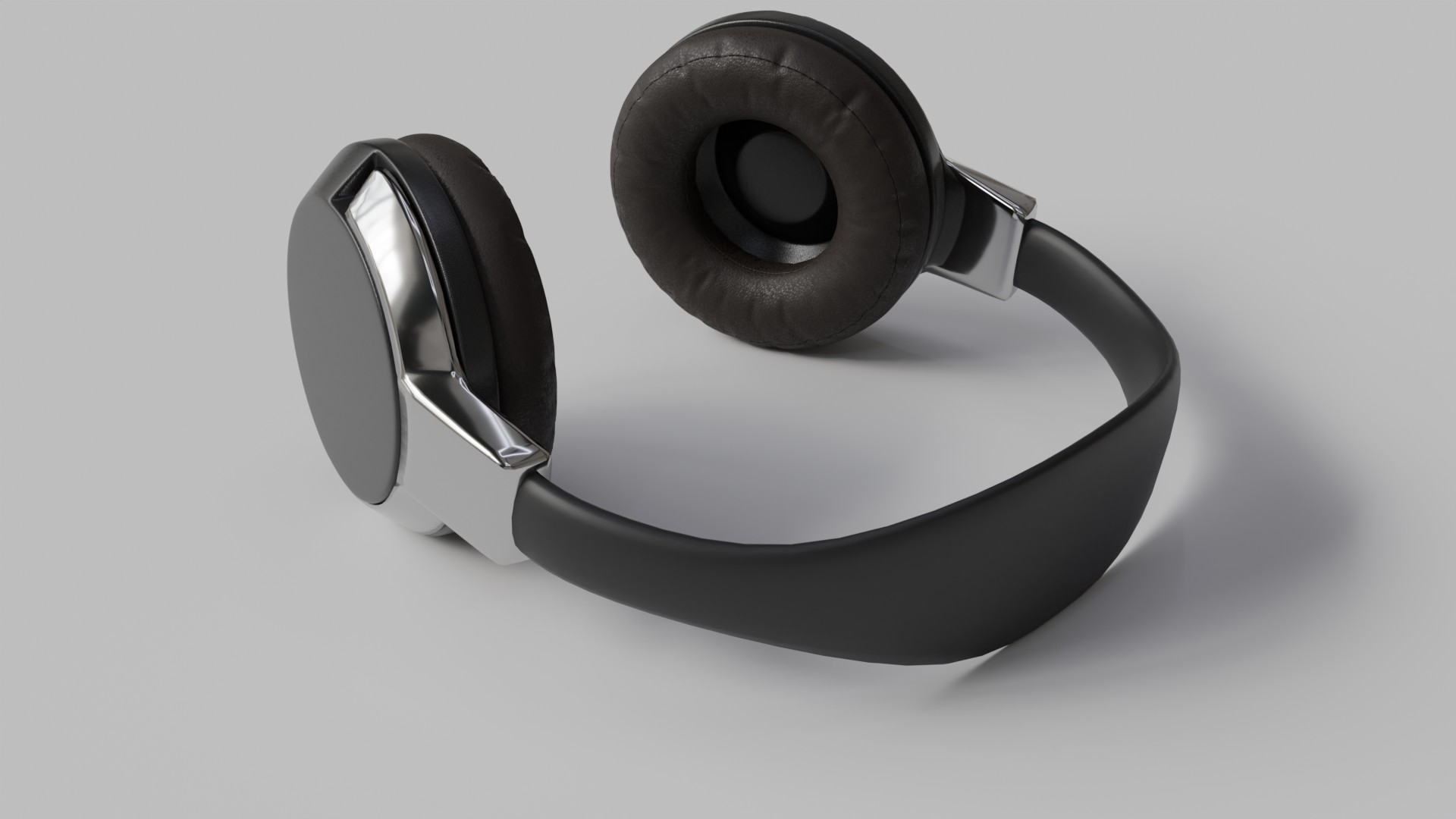

Lastly I wanted to show you my first modeling efforts in Blender, the essential doughnut (donut).
And a pair of head phones, about 2 hours modeling even with a cloth simulation!
This was a Derik Elliott tutorial if you want to give it a go.
