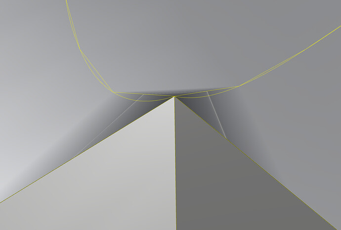

I am still somewhat new to SubD. I am working up a car body in SubD, whilst doing CFD in OpenFoam. I would like to keep the body in SubD for as long as I can, before chopping it to pieces, because I don’t have the actual frame and interior worked out to the actual n’th.
This approximation of a NACA duct submerged inlet was drawn from scaled official NACA drawings, so, I want to keep its shape pretty close before beveling it, also for as long as I can in the process, because there’s no way to unbevel it, I think. I think that adding some bevels might alleviate this problem, but I want to keep the accuracy as best as I can–for as long as I can.
The corners, my corners are crap. I’ve gotten them better by taking the tension out of them, but the very corners themselves, are indeed crap. After a few hours, I have the center line fairly good.
I know I have some triangles in this, and I also know quads would be better, but if anyone has an idea where my next split should be, I would be appreciate the advice, but I would likely try it. (Thanks)
I have tried flattening out the vertical segment and widening it a bit so that the creases don’t do Z as well as X and Y changes all at once, but that has not worked out.

I found that by making one seam an crease, to some extent the problem is transferred with lesser appearance, BUT, the hard seam will show…
…as you can see here:
I think I found the culprit: The issue may either be a bug, or the smoothing algorithm giving up at a certain point, throwing up it’s proverbial hands and breaking the edge, and using a straight line.
The curve that generates the mesh seems to have: a joined curve segment, or a curve node with different continuity.
At this point, I think this is a bug, because, if the nodes before and after the kink were included in the solution, the discontinuity would not be there, or would not be as horrid.
The plot thickens.
Ironically, if I duplicate that edge, that function actually does is correctly?
In the NACA corner, we can see segmented curves/lines (used for the wire descritalization?) compared to the copied curves.
In the upper curves, you can see the dependency between the duplicated edge and the SubD with the kink.
The funny thing is: I could see how at some point there must be an approximation, but, such as small deviation made such a noticeable difference.

hey Brenda- I responded with your file via tech support-
but here is the basic topo that looks better to my eye- Quad dominant and utilizing ngons where useful.
the other thing to think about…
subd does big sweeping surfaces great, but gets very fiddly when details are needed.
I always make my big main forms in subd then convert to nurbs, then add details like this in nurbs. You can do it all in subd, but it’s a much easier task and is using the right tools for each job to make your swoopy stuff in subd, and your details in nurbs… You do you, but that’s how I personally go after projects like this.
@Holo or @sgreenawalt make call BS on me here, but the reflections look good to my eye after a fem small bevels and getting rid of the triangles.
Making this stuff production smooth is not something I have mastered yet. I would use it for 90% design evaluation and then make the air intake in nurbs for manufacturing. So getting close enough in pure SubD should be the goal imo.

Obviously, adding the perimeter splits revealed the tension that caused the bug to become apparent in the corners, but the problem comes, when it’s time to add another row for radiusing that, because you are already pretty close to the edge.
I am not sure what those n-gons look like up close. Also, I have had to do a lot of rebuilding of structures, after Rhino has done me the favor in adding nodes.
The car shell still has been through the SubD >> OpenFoam >> SubD loop, at least twice, so far.
Why does the code that changes it from a straight line mesh to SubD–just quit and start using straight lines?
in that case i’d 100% switch to a hybrid approach and add the duct later in nurbs. You’ll never control it well enough in SubD to do what you are looking for.
It would be much better if they fixed that straight line in the approximation bug.

I’m with Kyle on this one - I think it makes far more sense from a workflow perspective to make your NACA duct in NURBS, and then add that into your master car OML surface, once you convert that Subd to NURBS. You should be able to go G1 or G2 at the front edge of the duct where it meets the hood very easily, and this will allow you more control/accuracy over making the duct in Subd.
One thing to note - the display meshes of the current Subd’s are significantly smoother at the star points than the NURBS conversion - especially if you drive up the display quality in the Properties tab. IF your downstream workflow allows it (might not in this case) then using the extracted display mesh vs the NURBS conversion of your subd is worth exploring.
