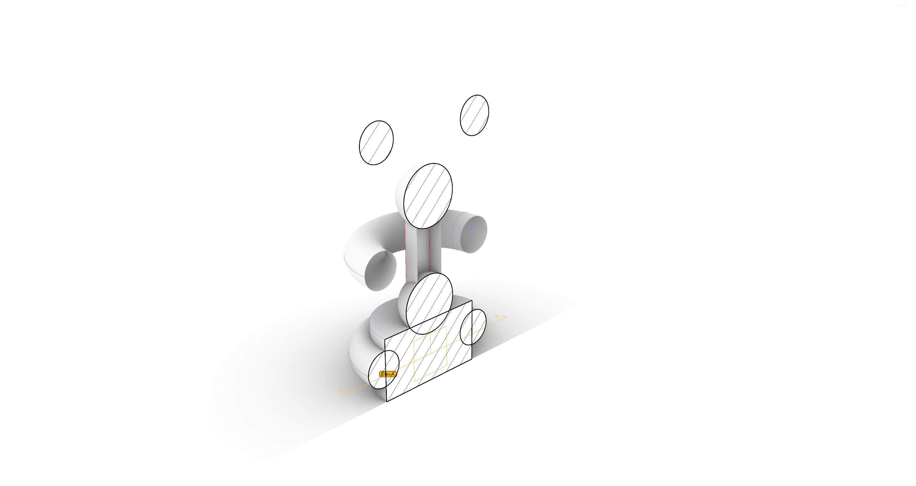

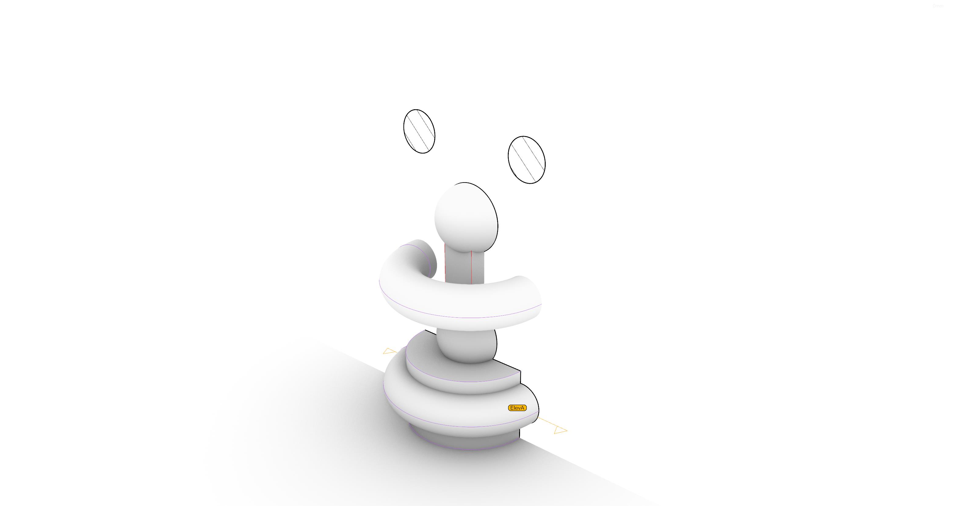

I dug a little deeper and am found this happens in a very specific workflow. I have a block in the referenced file, say Activation01, and there is the same Activation01 block in the drafting file. I use the code above to update the linked file which updates the block inside the drafting file. The geometry inside the block updates, but the section as displayed by the clipping plane doesn’t. I attached a screengrab to try and explain.
