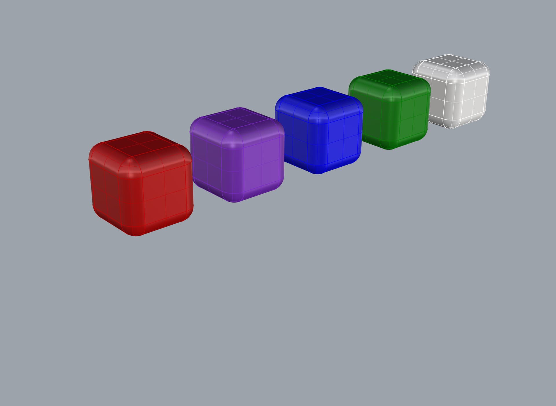

On two different computers when I have blocks in my model and the model is in Shaded mode I get these very weird “reflections” across the shaded items. I say reflections because they are huge blown up portions of what is in the actual model. I dont know how else to describe it. If I sell all the blocks the reflections cease. If I hide the block they also disappear. As soon as I deselect the blocks or unhide the blocks they disappear. Oddly each block seems to sponsor thier own reflections. If there are many blocks and I select one after the other they each turn off their own set of reflections.
I have attached a video of this phenomenon. Anyone else experiencing this? Anyone have a solution? Attached is my graphics card information as well.

From your video, it looks like you are using a custom version of the Shaded display mode. Does the behavior go away when you use the default Shaded mode?

first viewcapture: new rhino file _box _filletEdge
second: paste 2 blocks…
The solve here was a setting, specifically the Lighting scheme’s Lighting method tab. I had Custom lighting selected and that was causing the reflections. Changing the lighting method to No lighting solved the problem.
