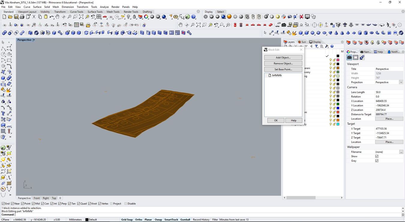

Hello everybody
Got exactly same display issue in V6 and one moreover.
First one i can now solve, so take a closer look to my second issue.
Can not see (all) contours when blocked :confused:
Display Mode - Shaded :
Display Mode - Shaded - whole block selected
BockEdit Mode
BockEdit Mode - one surface selected
Thank you!
Looking forward to your answers and solutions
Petr

Hi Petr - a couple of things to check - the main one is a check for updates - you have 6.8 and the current Rhino is 6.11, so get that updated first - Help menu > Check for updates. Second, the objects are quite far, not super far but nevertheless quite far from the origin - if the update does not fix things, see if moving the object to the origin does anything - that may at least help in finding the problem. ( Your block looks correct here, so far)
Hi @pascal
Everything works fine after rhino was updated
Thank you!
