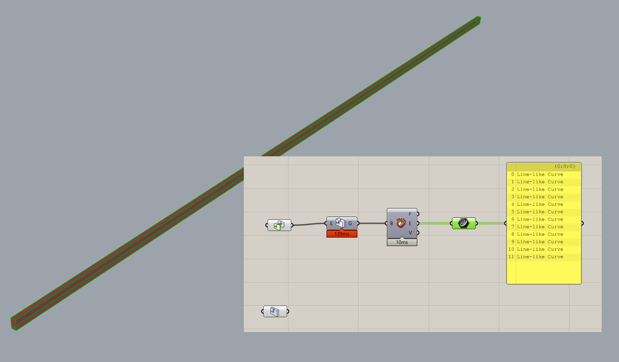

I worked succesfully with the Rhino insight Revit in September but updated the Rhino WIP and Revit plugin release today which causes problems while referencing geometry now.
When I select some geometry with the geometry or edge parameter in the the project it causes an error which causes GH to stop working until I close all documents. The edge select component does not seem to work at all on the project level.
Also components from the definitons from September don’t show up anymore when loaded now!
Do I miss out something here?
I would be very glad for any hint to solve this issue.

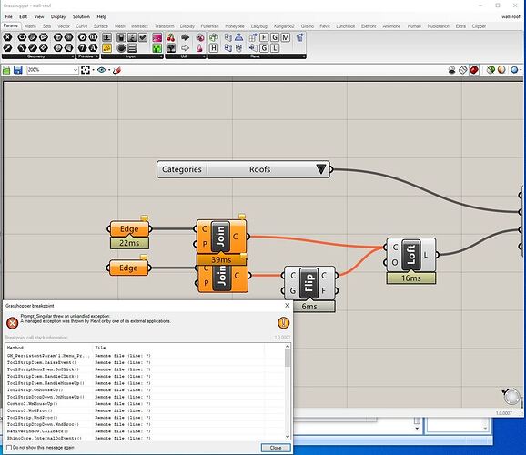

Thanks for looking into it. I installed the lasted release but still I have trouble referencing the geometry or edge of this beam which worked before!?
I’m unable to read the message in your screenshot.
May you do an screenshot only around the error message?
It looks like you are using a HiDPI screen and discourse doesn’t like high resolution images.

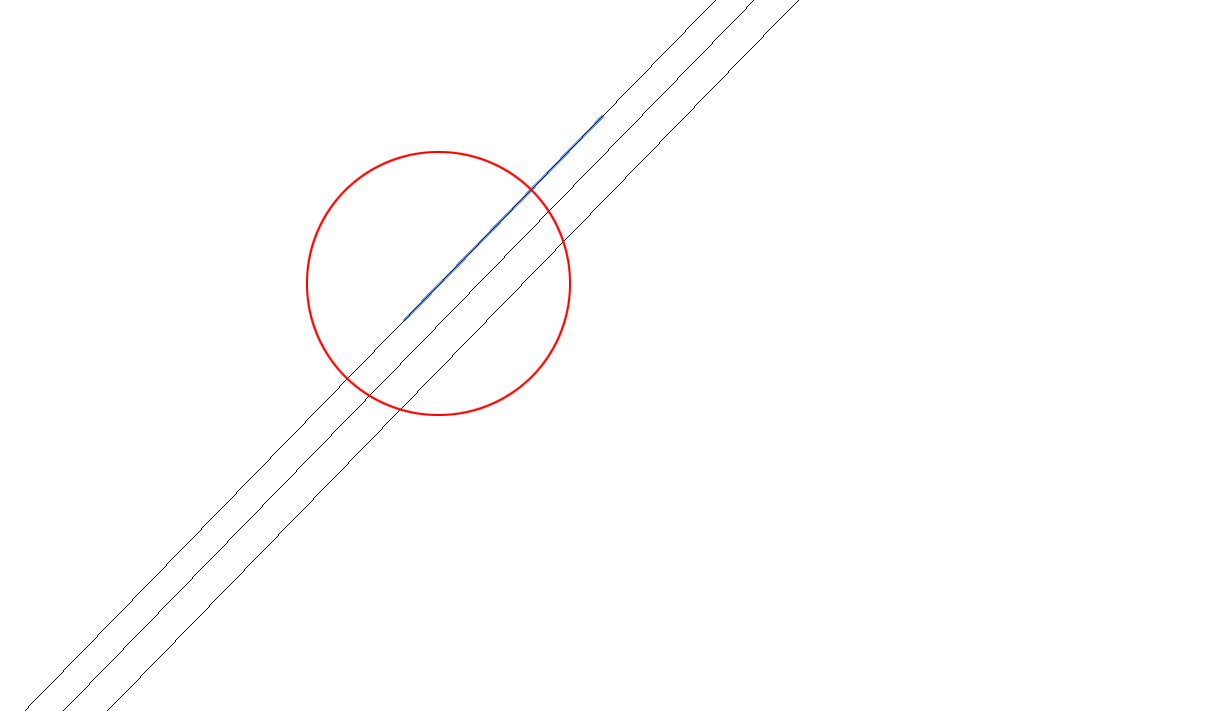

The referencing in general works now. Geometry reference works but for Model Lines for example the TAB button to select connected lines or objects does not work only one by one.
The Edge reference works too but here is the issue now that it does not allow to select the entire edge of a connected beam and TAB is not working either. Only bit by bit the edge can be selected and only it the obeject is isolated.
I just switched to Revit 2019 - the issue with the selection of sub-edges instead of the whole edge does not seem to be the case compared to Revit 2017.
