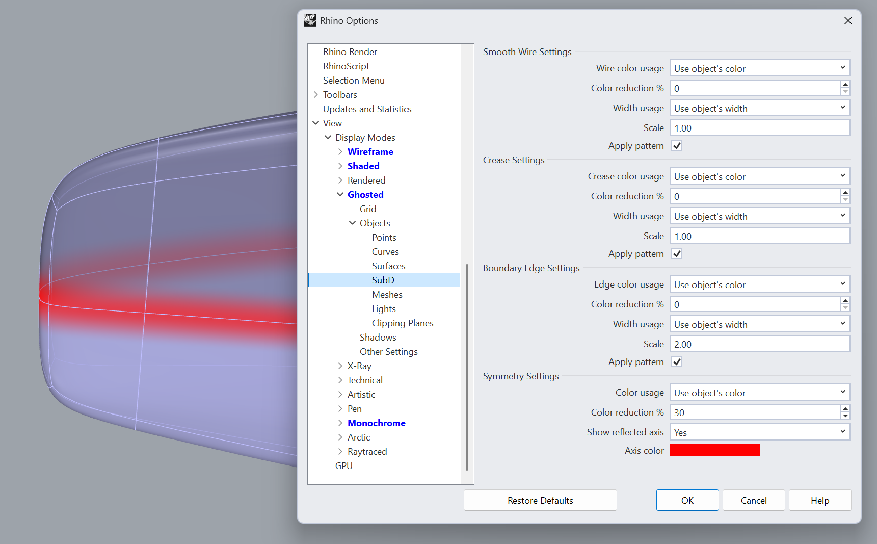

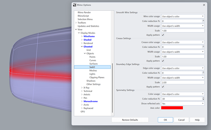

Red SubD reflect line is puzzling me
In the attached file, you can see the red line at the SubD reflect x-axis. However it is going from very thin in the aft ship to quite wide in the foreship. What does this indicate?
AFAIK the topology of the SubD is correct.

I didn’t look at your file. The symmetry display seems to be thicker when the definition is less dense.

Your answer might be it. And if that’s the case, the blurred thick red line in the foreship is not useful to me.

I also think the edge should have constant thickness and the symmetry settings should have an option to choose the thickness
Thickness setting was requested 5 years ago already…
i think its a bug (feature) that got introduced recently, i cant remember having seen this ever before and it also shows up on geometry that is evenly dense either
I’ve logged this bug a while back.

… no this one is more about zoom -level and size:
i would appreciate if the the red shining “edge is reflect”-indicator has a constant pixel width.
as a surface edge or a dot.
does this make sense ?
kind regards -tom

RH-89840 SubDReflect line appearance
RH-89840 is fixed in Rhino WIP
