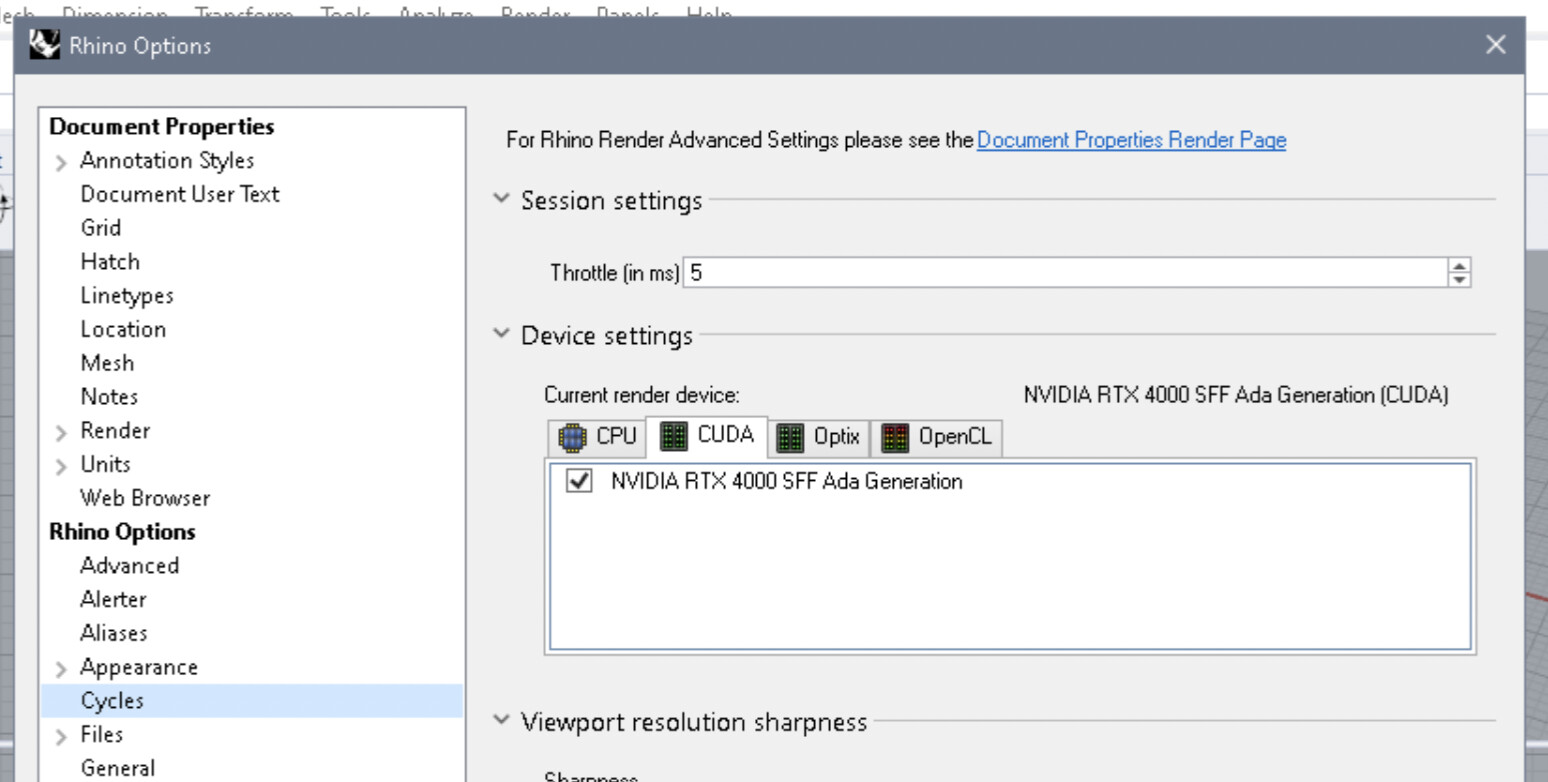

Go to Tools > Options > Cycles, make sure that on that page under device settings your 1050 is selected for either CUDA or OptiX.

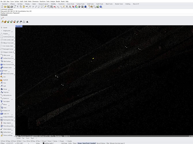

Then, when switching to Raytraced click in the HUD in the bottom of the viewport on the word Raytraced. It should now show you what device it is using for the raytracing.
Post a screenshot of both the settings and the viewport with HUD showing render device.
Thanks for your response! My 1050 is selected for CUDA, CPU is unchecked in CPU, and I have no options in Optix.
+ a screenshot of essentially no load on my GPU, which I know isn’t that beefy but I thought it would be able to help with the render. I have done everything I can to force Rhino to use the GTX1050 in Windows, Rhino, and NVIDIA settings (that I was able to find)
You shouldn’t be using the task manager to look at GPU utilization. What you are looking at is 3D drawing, but Raytraced is not doing 3d drawing - it using compute, and that most definitely will be on high utilization. I typically use MSI afterburner to look at that (around 45% for this simple scene):
Your Rhino 7 most definitely is using the GPU to render.
Your GTX 1050 isn’t terribly strong. I suggest not maximizing your viewport with Raytraced to retain some responsiveness. If you’re using this to do “look-dev” then I suggest turning down the sharpness and responsiveness sliders (in Tools > Options > Cycles). Remember to switch away from any running Raytraced and back again after making changes to options.
Then final rendering do that with Rhino Render - it us the same as using Raytraced, just that it is the production renderer, rendering in a separate render window.
