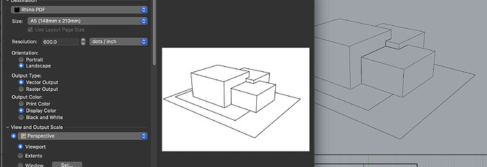

I’m trying to export / print 3D models in black&white with vector lines without using Make2D.
In the example below, I used an modified displaymode “Technical Linestyle” to accomplish the desired visual outcome.
The viewport looks fine, the preview when using RhinoPDF printer in Raster mode also looks perfect, but when switching to Vector output, the model shows partly transparent.
Note that it doesn’t show the full model as a wireframe, see the example when using the default Shaded display mode as a reference.
To me it seams the Technical Viewmode is showing some hidden / back edges randomly.
Somebody got a clue what’s happening and how to fix this?
Raster output (how it should look):
Vector output (wrong):
Shaded displaymode in vector as a reference to the full wireframe
Wish I could export 3D models with vector output without using Make2D..
Thanks in avance!

Could you please post both the output from the Rhino SystemInfo command and the 3dm file that you are seeing this in?

Sorry for the late response. I created a new model from scratch, repeating the issue shown before. See the attached .3DM.

Dank je, Ronald -
I’ve filed this regression as RH-86993 Print: Messy Vector Print from Intersecting Objects
Bedankt, Wim!
Any prediction how long it would take to fix this regression? Looking forward to the solution.
Dag Ronald -
The fix for this issue was committed into the 8.20 branch of Rhino 8. A first public release of 8.20 as a Service Release Candidate will become available on Tuesday May 13th. If this is something that you urgently need, I could send you an internal version with the fix in it, but those are very little tested and could be unstable. An alternative would be to go back to 8.13 but many bugs were fixed since then…
RH-86993 is fixed in Rhino 8 Service Release 20

Thanks for the quick fix. I downloaded the latest SR Candiate.
It turns out the Vector Print using the Technical displaymode now works correct for 3D geometry.
Unfortunately, when curves are visible in the model, they are still drawn through solid elements as if it is a wireframe model.
The model in viewport
3 solid boxes intersecting and 2 rectangles / curves below.
Vector print output
the solid boxes clip as expected. The curves are put in front.
Could you find out what’s the issue here?
Thanks again, Ronald.

I’m not seeing that happen here:
Could you please post both the 3dm file and the output from the SystemInfo command?

I found out it has something to do with my modified Technical displaymode.
When using the default Technical mode, unticking “hidden lines” it works as it should in both raster and vector print mode.
Here is my system info, the 3dm file and the customized displaymode.

Hoi Ronald -
Sorry, I can’t find a reason why your custom display mode makes vector print behave this way.
I’ve put this on the list of the developer for a closer look → RH-87879 Print: No Curve Occlusion with Modified Display Mode
