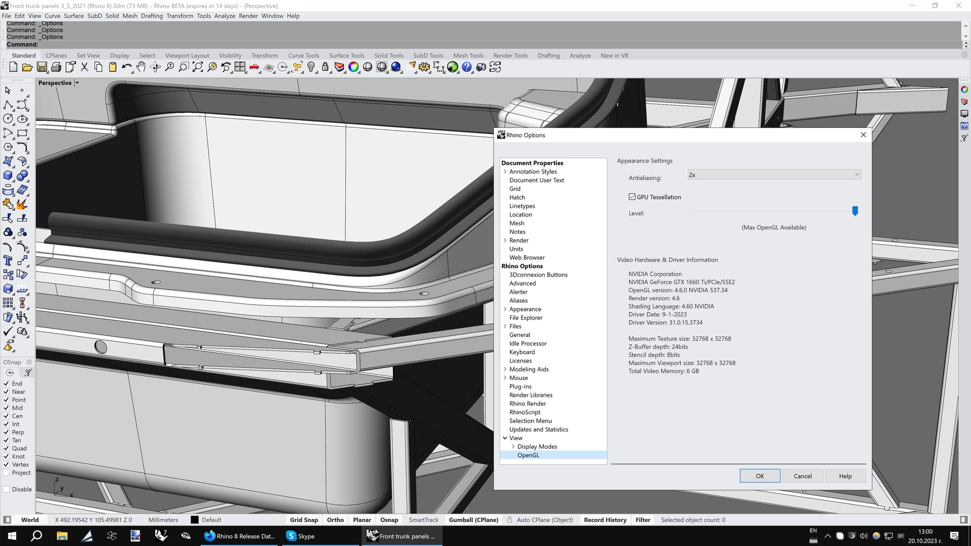

I also experienced that in my Rhino 8 WIP for Windows 10 months ago, but since then it was fixed and now Rhino 8 BETA is smooth on Windows 10. Only the Rendered display mode exhibits frame pacing issues even now, but I guess it’s related to the shadows used in this particular mode.
Oh, yes, and here is the difference between 2x and 8x Anti-aliasing in Rhino 8 BETA (Rhino 7 is so much better in making the lines super smooth even at 4x):
