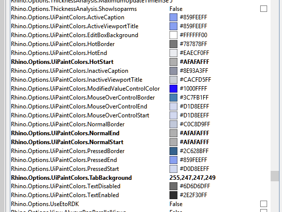

Guess I have to go through all of these and see if any of them help. It’s of course trial and error, as there is no real guide as to what the settings affect. Oh well.
I believe the right persons to help you here are @brian, @stevebaer and possibly @johnc
I answered Mitch’s question about EditBoxBackground in his other thread on this topic.

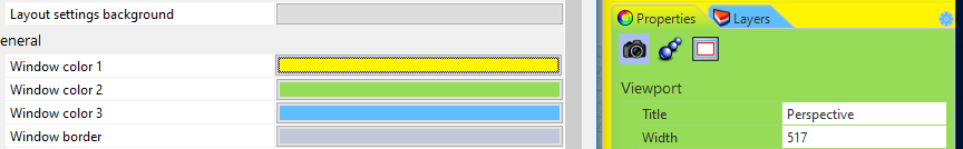

I can answer about the ‘flat’ tab colors. It’s possible to change the colors in Options/Appearance/Colors so that the tabs have different shades. Here is an example with exaggerated colors to demonstrate:
John
It looks like WindowColor3 is broken in Rhino 7
