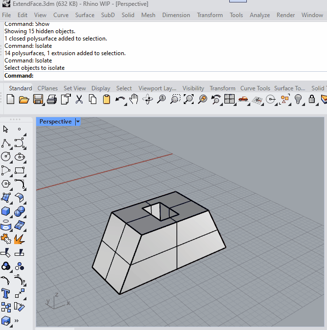

It’s on my radar. I’ve done some work for face extension on planar stuff that’s hopefully on the way soon.
Extend_Face_1
Extend_Face_2

this extend mode is super useful i deal a lot with excavations which is basically truncated pyramids. please develop it eobustly so it does not fail with more complicated geometries…
Yes, that paper is the inspiration for the face extension mode. It’s a bit more complicated with polysurfaces but it is a really great piece of research.
