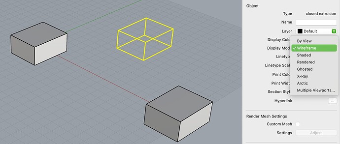

@dale do you know if I can set some objects in wireframe mode and some in shaded mode in the same viewport??

Use _SetObjectDisplayMode command in Rhino. This will not affect the bounding box setting Dale mentioned, but will also help to speed reference models’ display if you set them to wireframe.
Thank you @Toni_Osterlund I didn’t know this command. Also, I found a quick way to do the same, just in case anyone out there is having the same issue: you can change the display mode of the selected object in the property panel. Find the image below.
