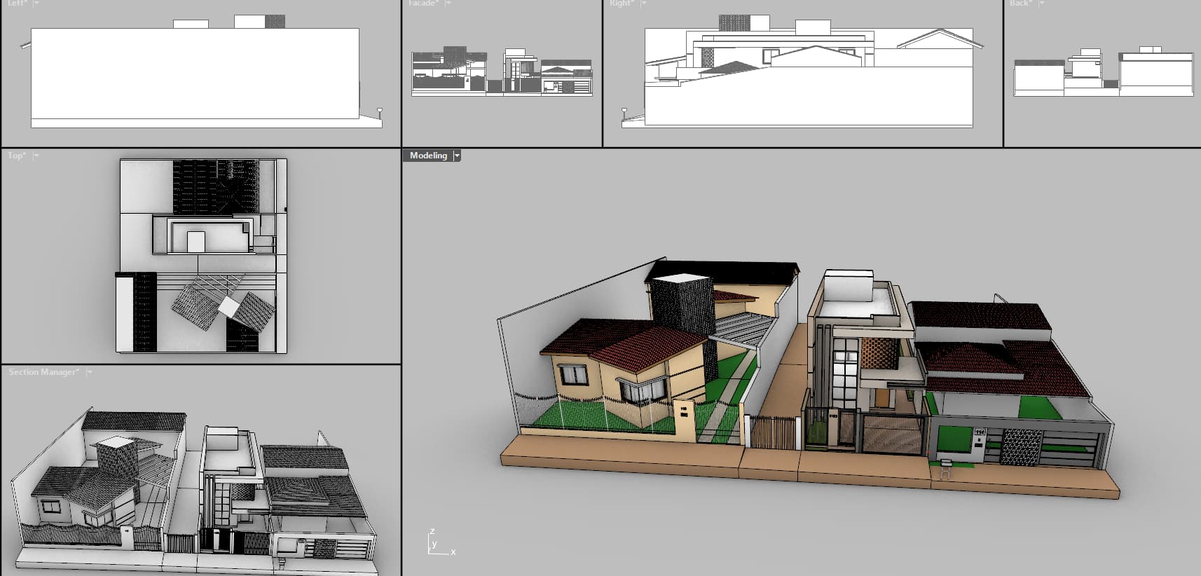

Hello. I’m actually modeling an architecture model and by now it has 0.85G. Saving takes about 2 minutes. Is there any way to make rhino file lighter? It is lagging depending on situations.
I accept modelling sugestions. All the model has been modeled with NURBs geometry. Heres some pictures.
I think the heavier geometry are on those gates, 3D texture wall and 3d modeled roof
How do I make this textured wall pannel lighter?
How to make roof lighter?

Extract the render mesh of the roof tiles, select them all and join them into a single mesh. Do the same for all the cubes on the wall panel and the fence: ExtractRenderMesh, select the meshes and Join into a single mesh. With join, make sure to run the command without any preselection first to make sure that JoinDisjointMeshes=Yes, or else Rhino will not join meshes that don’t share edges. It might not make the file smaller, but it should work wonders for the response on-screen.

Thanks a lot @Normand i didn’t know the ExtractRenderMesh (I dont know whow to mark commands in the forum yet) command and its surprisingly fast (faster than the Mesh command).
I believe its not all roses. Is there any pros and cons of using it? I want to know when to use and when not, whatelse I will ExtractRenderMesh all the model before rendering it :smiley:

Well, the drawback of extracting the render meshes is that the objects are now meshes, so editing them isn’t as straightforward as when they are NURBS. What I usually do is just make separate layers, one with the original NURBS objects and one with the render meshes - and then turn off the NURBS layer. If editing is needed, just turn the layer back on and extract the render meshes again. That will of course grow the file size, as meshes can be quite heavy in terms of disk space, but I think it’s worth the trade-off (which is of course easy to say, when there’s 54 TB of space on the server).
Rhino (and practically all other NURBS modelers) all create render meshes, as displaying NURBS geometry directly on screen is a lot of work/slow. Every time you create/edit an object, a render mesh is created for you to see on the screen, but it exists only “on screen”. In shaded view, ghosted view etc., the NURBS isocurves and edges are superimposed on top of that mesh (and the mesh wires are hidden), so all you see is the surface in its “NURBS-form”.
Another draw back is that disjoint meshes (meshes that are joined without physically touching edges) have to have the same material and UV mapping type, which can be limiting; but for repeat geometries like roof tiles, windows, plants etc., it can really make things a lot easier to navigate.
What ExtractRenderMesh does is simply to make that underlying mesh available to you. How precise/detailed those render meshes are is set under Tools>Options>Document Propertes>Mesh, so if you ever run into render meshes that are too coarse, changing those settings can alleviate that. There’s a couple of pages dedicated to just render meshes and their precision here and here.
For things like roof tiles (when dealing with NURBS), it might also be an idea to look into the custom render mesh settings, located in the properties panel of any given NURBS object(s).
There you can set specific render mesh settings for any object(s), so if you need fine and detailed meshes for some objects, but can settle for really coarse meshes for others, you can select a group/layer of objects and assign them their own settings, overruling the settings in Document Properties.

Hello @Micha. I used blocks just for the gate bars. I tryed to use the blocks in this 3d wall, but it started laggig a lot, then i remade them as a solid an then ExtractRenderMesh and will neve use them again.
Its kinda sad blocks are so hardware consuming, since it is one object that is replied.
