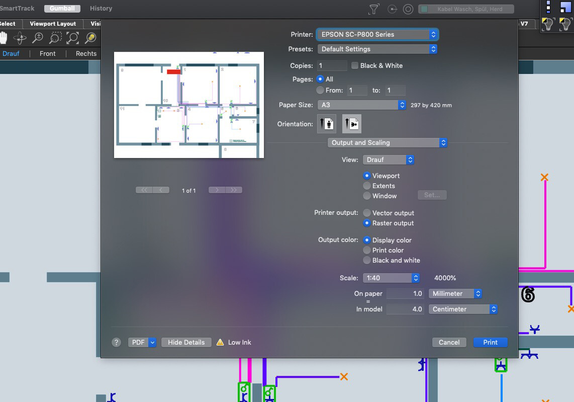

Hi – I have designed a floor plan for an electrical installation in Rhino and wanted to print it. This is what it looks like in rhino:
This is my print dialog:
But what I get is this – the left rooms are printed twice and the rooms in the middle are not printed at all. If I print into a pdf same thing.
I had this before with other files – sometimes it works, sometimes it doesn’t and I get some parts printed twice and other not at all. Something wrong with my settings?
Would appreciate help, since I often need print templates and the like.
Thanks in advance - Jan
Hi -
Can you get it to print correctly if you use the ExportAll command and pick the PDF format? That will use the Rhino PDF printer and not the macOS printer that we have little or no control over.
Well, yes, that worked fine … as long as I am in wireframemode. If I go to shaded and export then, I get this:
Lögow-Aufriss-2021-2.pdf (63.4 KB)
But for most of my applications wireframe will do, just for this one shaded might have been a little clearer. But well - thanks a lot anyway!
Hi -
Yea, that doesn’t look any good. Could you please run the Rhino SystemInfo command and copy-paste the result here?
Yes, of course, here it is: systeminfo-4-6-21.txt (2.7 KB)
Hi - that only contains part the information, it seems. Could you try that again?
Sorry … now by copy paste:
