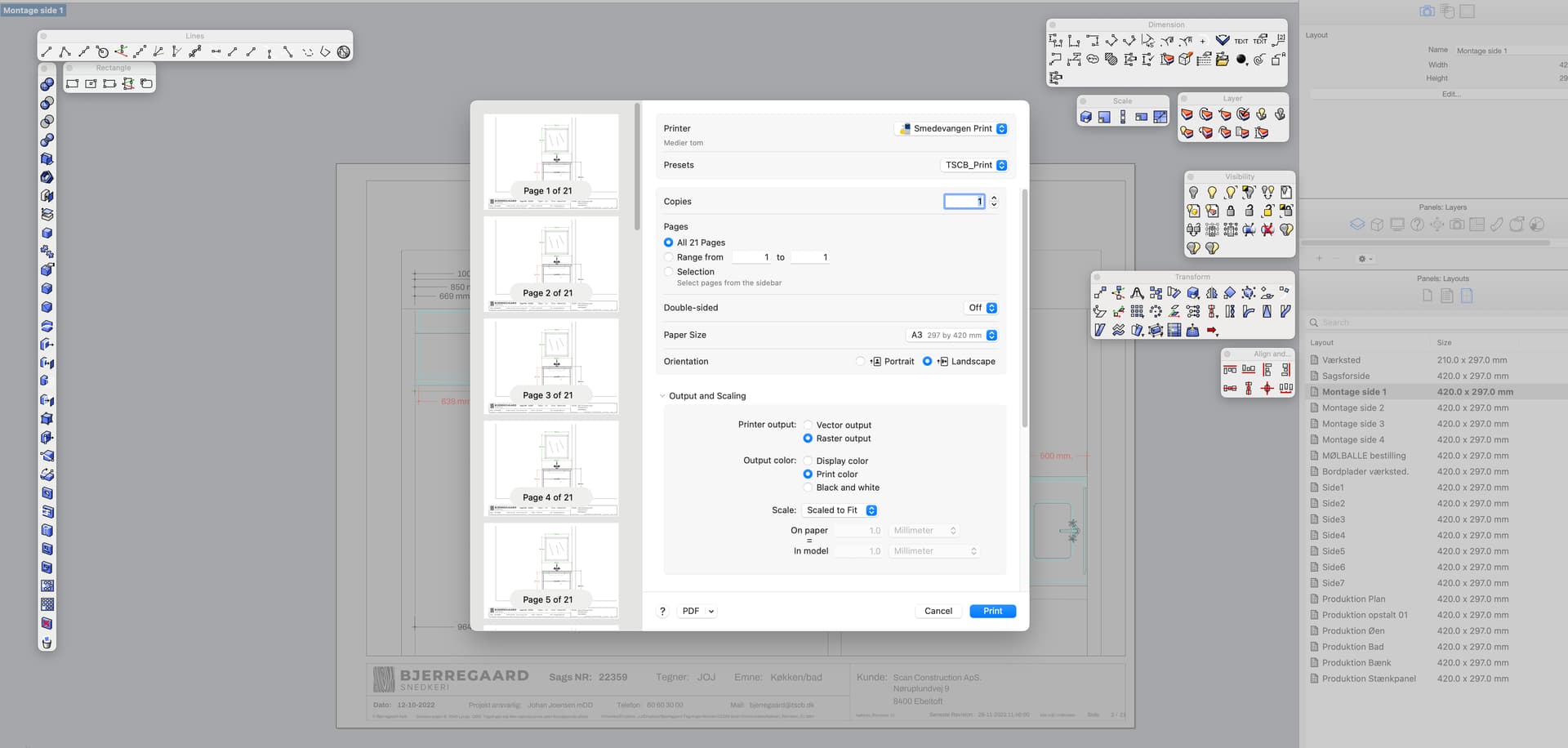

I can’t share my model due to an NDA agreement. Usually i go into layout mode - click on a page i’ve created and set up and you are right i click cmd + p (to print). This usually helps me see what I’m working with as well as allows me to save a PDF. As that is the format I usually need or want scaled at 1:1 for however I’ve laid it out on a page.
Oh i see so export is better than the print command? But can the print command be fixed as prior it worked fine before.
We are still trying to figure out what needs to be fixed. It looks like Apple changed something with respect to their standard print dialog that is causing Rhino to be slow in the latest version of macOS (Ventura). Once we can reproduce the issue, then we can start figuring out what to do next.

Here is a print screen of how it looks on mu mac.
i think it´s the pagepreview funktionality that takea all my processor power and makes it realy “heavy”
