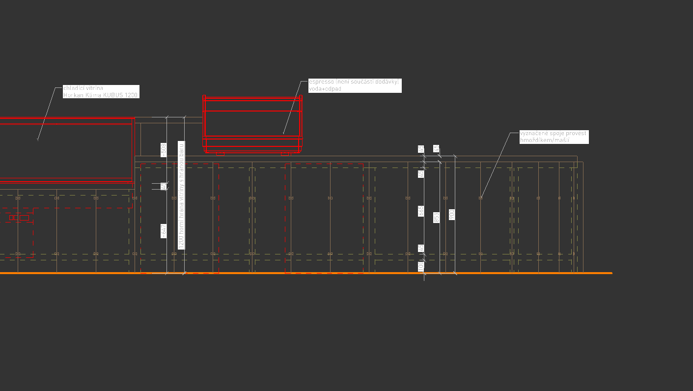

model space:
raster pdf layout export:
vector pdf layout export:
