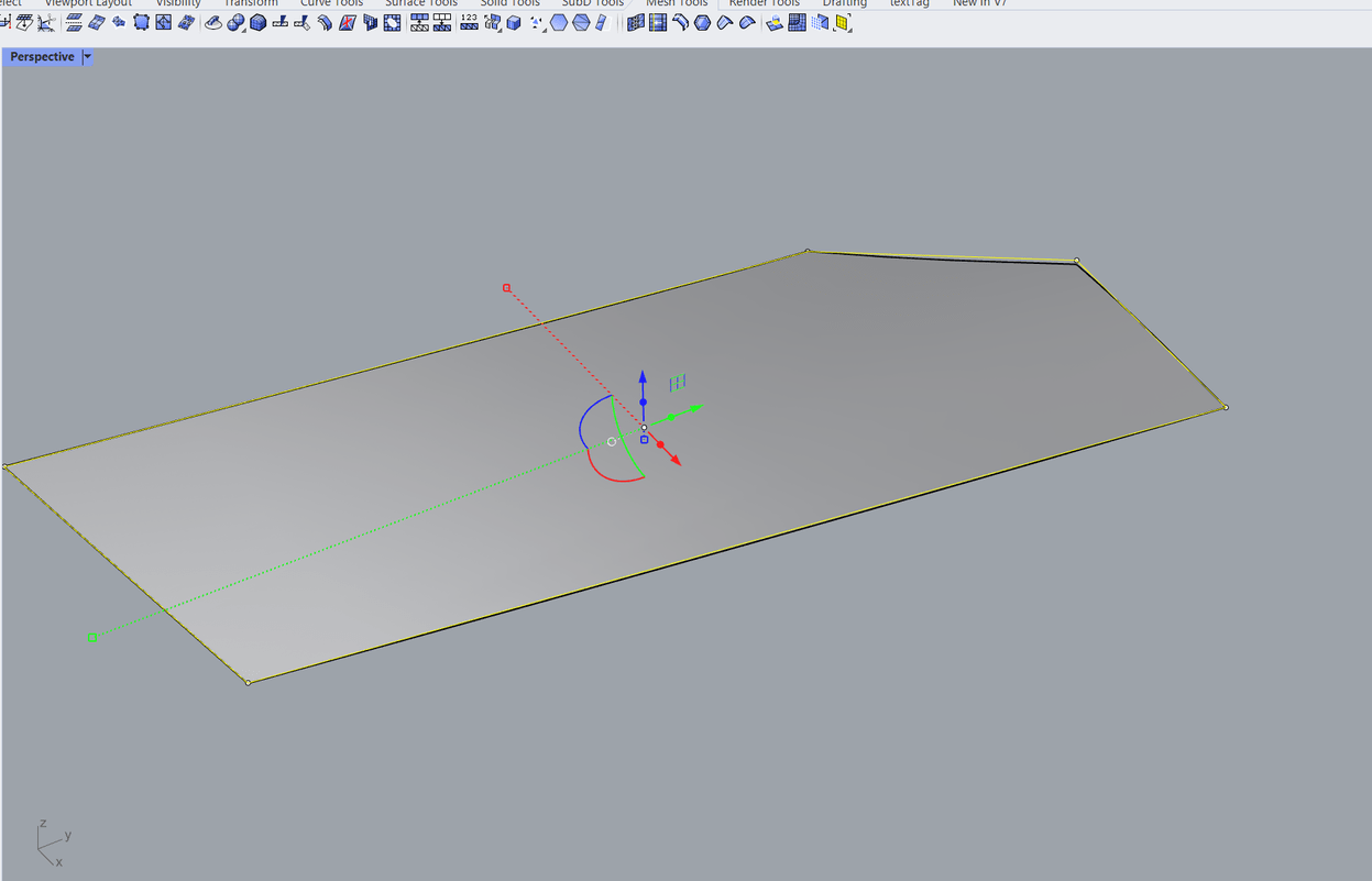

It’s a closed curve that actually represents a portion of a sidewalk.
I have tagged the height of some points for you to see that the curve is not planar.
1 - Surface method :
When using patch, the surface does quite match the closed curve (even with proper stiffness and UV parameters). I suppose that the patch command flows a surface that matches a collection of points. But i need the surface to perfectly match the contour line.
2 Mesh method
When trying to create a mesh, by extract more points from the outline curve, the mesh goes outside of the outline.
I am looking for a way to make a mesh or a surface that matches the outline curve input. (an equivalent of the “meshfromclosedpolyline” but with a closed curve input instead of a closed polyline).
What i have done is converting the curve into a polyline with A LOT of control points, but i find this methode a bit skecthy and time consuming.

thats why terrains are represented by meshes because they are not “mathematical”. creating surface from closed non planar curve is an ambiguous problem. The best way could just be to add some points within the closed curve and run meshpatch http://docs.mcneel.com/rhino/5/help/en-us/commands/meshpatch.htm
i have done the same thing many times. the best command for this is definitely sweep2. thats just our imagination that we can fit imaginary surfaces inside the edges but algorithmically it is impossible to simply determine how surfaces should be created and combined.

if you scale your edges 10x in Z you will see that it would need to be crazy complex surface to be smooth and yet connecting to all edges. i am aware of a grasshopper component which creates minimal surface according to minimum energy method but it expects closed periodical curve, not a polycurve. i believe there could be some mathematical/geometrical method which could create such surface/polysurface out of any arbitrary closed polycurve. but this is realm for smart guys like @DanielPiker
I usually deal with the same type of task at work, and this GH definition works every time. You don´t have to prep the curves in Autocad, the definition will create the points, a mesh, and then get rid of the outside faces. The accuracy of the result will depend on the amount of points you create as you know.
