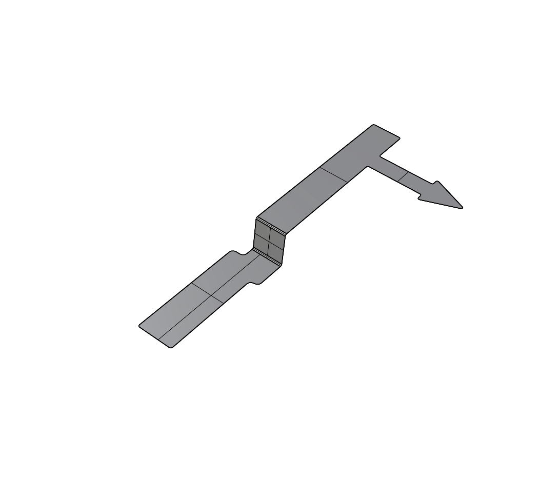

Best way of creating a surface from non planer closed curve
I’ve tried a bunch of different things, but short of braking this up into lots of little curves and creating lots of surfaces from planer curves and then trying the join them all together, I’m thinking there must be a way more straightforward way of doing this ??? Attached is an example of the curve I’m trying to use. Any ideas ?
non planer curve.3dm (3.7 MB)
re_non planer curve.3dm (135.1 KB)
two _PlanarSrf surfaces and 3 _EdgeSrf surfaces
no there isnt… you have to explode curves then
non planer curve_emod.3dm (139.9 KB)
for those who like trimming srfs everywhere :face_holding_back_tears:
side note: grid bug still not fixed.
use some of the segments (green)
_extrudeCrv splitAtTangents=Yes bothsides=yes
extend the surface it with _extendSrf or sub-Selection / Gumball
_trim
_shrinkTrimmedSrf for beauty
