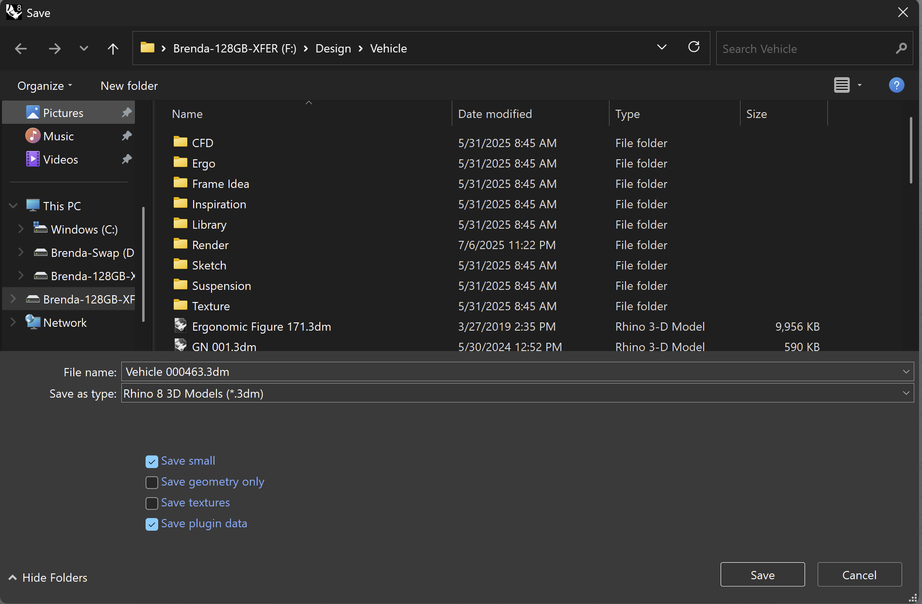

What I want to do: Do a quick, incremental save small as a means of versioning.
What I have to…
1.) Invoke a Save
2.) Uncheck Save Materials
3.) Bump the Filename (optional)
4.) Save
Doing medium to large projects with versioning, embedding materials makes little sense, and wastes a lot of space, slowing saves. Generally, I don’t embed materials.
Notice the filename number. Doing incremental saves have saved me from project dead ends.
If it would either save small without textures, or save incremental without textures, it wouldn’t be so bad. I used to do both.
How about using -_IncrementalSave put it in a button with SaveSmall=Yes and SaveTextures=No. Would that work?
Thank you. I will try it, but and I hope I am wrong, that has been broken for the last few releases.
I will try it.

I don’t know the argument separator?
This, however prompts for texture save:
! _Save SaveSmall=Yes SaveTextures=No
You actually only need to run _IncrementalSave once manually, setting both options to what you want. This will be remembered across sessions. You then just need to use _IncrementalSave.
For your -_Save macro you need to end with an _Enter like so:
-_Save _SaveSmall=_Yes _SaveTextures=_No _Enter
