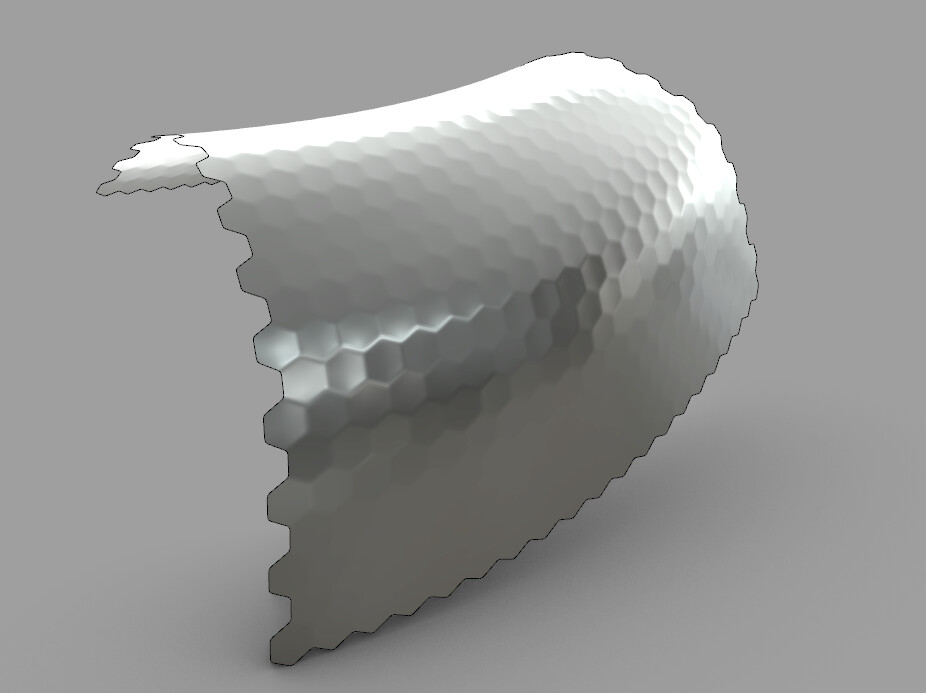

Good morning.
I want to make Planarize Hexagon like this photo.
Does anybody have idea to do this?
Connecting edge might be smooth.
Any help would be greatly appreciated!!

Those hexagons don’t look flat to me.
What is it you are actually trying to do? a bit more detail would help.

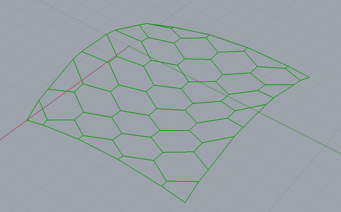

Thank you Daniel
I want to make this kind of shape from surface.
Used LunchBox Hexagon Cells
And Calcuated to be planar
But there are gaps so I can’t connect.
Filnally I want to make fillet to Edges , so I want to connect roughly.
Please Help!
By merging point, wire was made.
But this hexagon is not planar so I can’t make surface.
But I don’t want exact plane, Roughly planar and Edge fillet is needed.

I’m pretty sure the nature of that surface means that it’s geometrically impossible to planarize the hexagons and also have the edges match up. Concave or convex works. Both does not. And this looks like both.
If you’re just after that look of the smooth hexagons with softened boundaries between them you can do it like this:
hexagons_soft.gh (11.1 KB)
I’m sorry Joseph.
File attached.
PlanarizeHexagon.gh (23.4 KB)
Thank you so much Daniel.
Almost What I want !.
I just understand Python , I will try to undeestand C# next step
