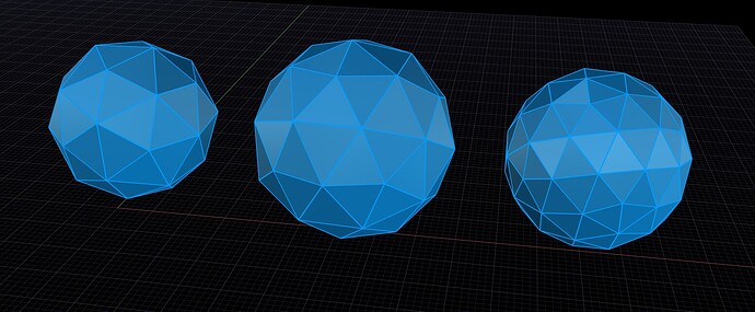

You might be able to get better results by downloading the Rhinopolyhedra plug-in. Weaverbird gives you an icosahedron and the ability to subdivide. Rhinopolyhedra gives you a huge variety of geodesic spheres, some with triangular faces, some with quad faces, and some with combinations of hex and pentagonal faces. The normals on those geodesic sphere faces will either point straight at the center of the sphere or much closer to it than a subdivided icosahedron’s normals. But if they’re still not perfect, just using the volume centroid of the sphere as the start of a line and the centers of the faces as the other end will probably get you much better results than you’re getting with the icosahedron.
Here are geodesic icosahedra patterns for 60, 80 and 140 faces:
The plug-in offers options up to 1580 faces for icosahedra. Geodesic cubes start at 12 faces and go up to 384. There are two other geodesic sphere types, too. Many many possibilities. The grasshopper version of the plug-in may allow you, with some work to create a way to create a list of geodesic polyhedra sorted by number of faces.
None of these are perfect divisions of a sphere, only the platonic solids do it perfectly, but the geodesic spheres are close compromises, one of them is the source of the most famous golf ball dimple pattern, for instance. If you want an increasing number of holes, spread out as evenly as possible, your lowest numbers of holes should be derived mostly from the platonic solids, possibly adding tapezohedra or another partly symmetrical polyhedron for 10, 14, 16 and 18 faces.

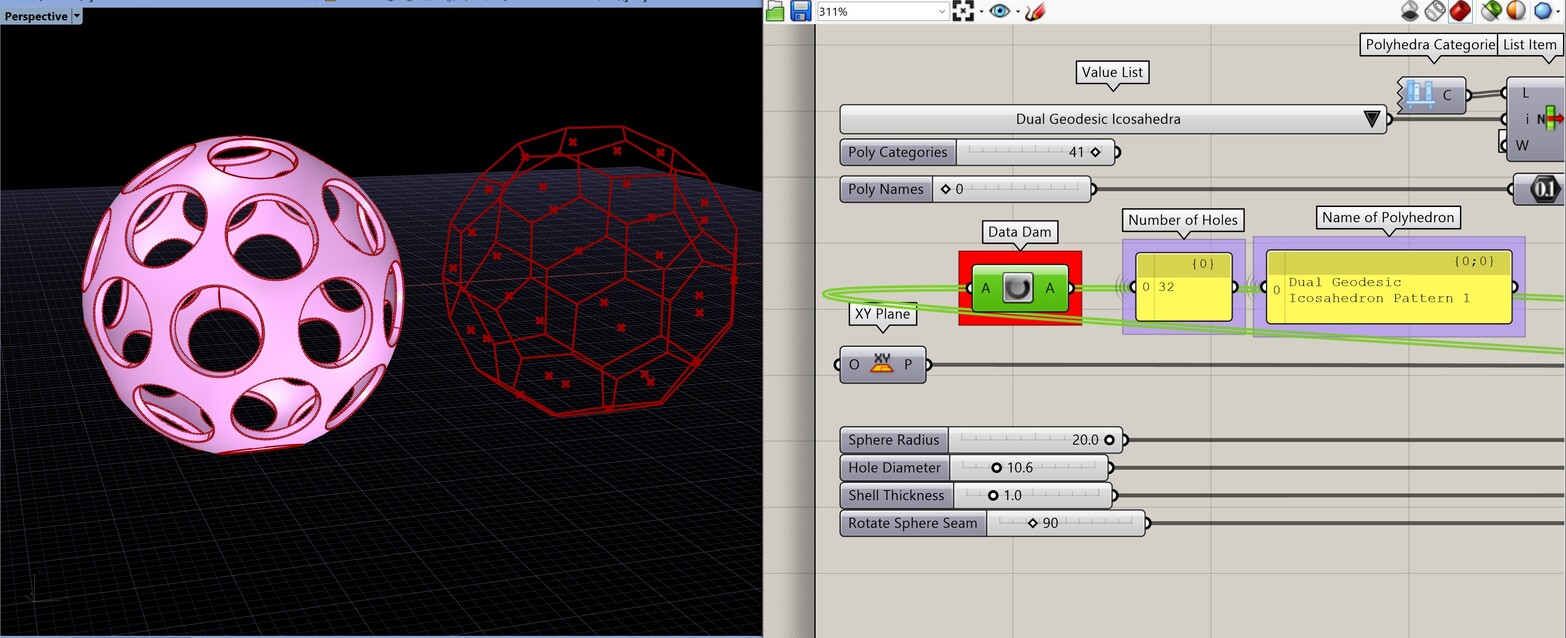

Here. I made a definition using Rhinopolyhedra. Only plug-in you need to download for this is Rhinopolyhedra. Once installed it lives in the native Mesh category.
Holey Balls.gh (46.1 KB)
My version makes holes that are conic, not cylindrical, but it should be pretty easy to change to cylinders if you need that. I’m also having some issues with holes failing on the sphere’s seam sometimes.
But if you just want a wide variety of hole patterns, you can swap the Rhinopolyhedra part of my definition into your definition, maybe?
